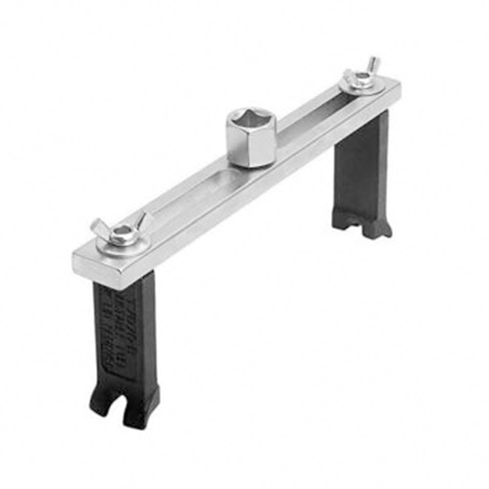

That's my question- pump assembly or that evap tube. Not sure how to determine which. Any direction on where to find the fuel pump assembly  ring tool?

FLAPS should have that wrench to remove the tank lock ring for sale or rent.

You can remove it with a screwdriver and tapping it with a mallet.
