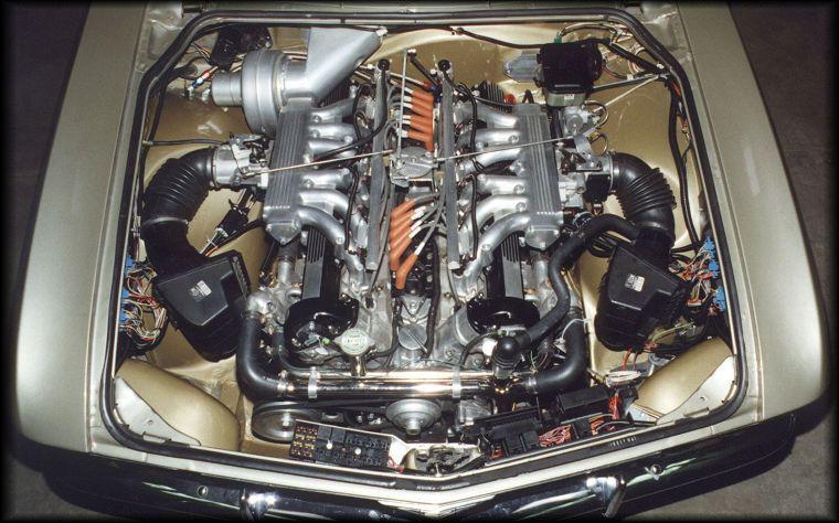

I have certainly seen front engined V8 Corvairs, but the are usually drag cars.  Years ago someone in Northern California put a Jag V12 in the front of a street driven car, so it's certainly doable.  One needed change will be moving the gas tank since it sits at the rear of the trunk in stock form.
I think this is the car?:

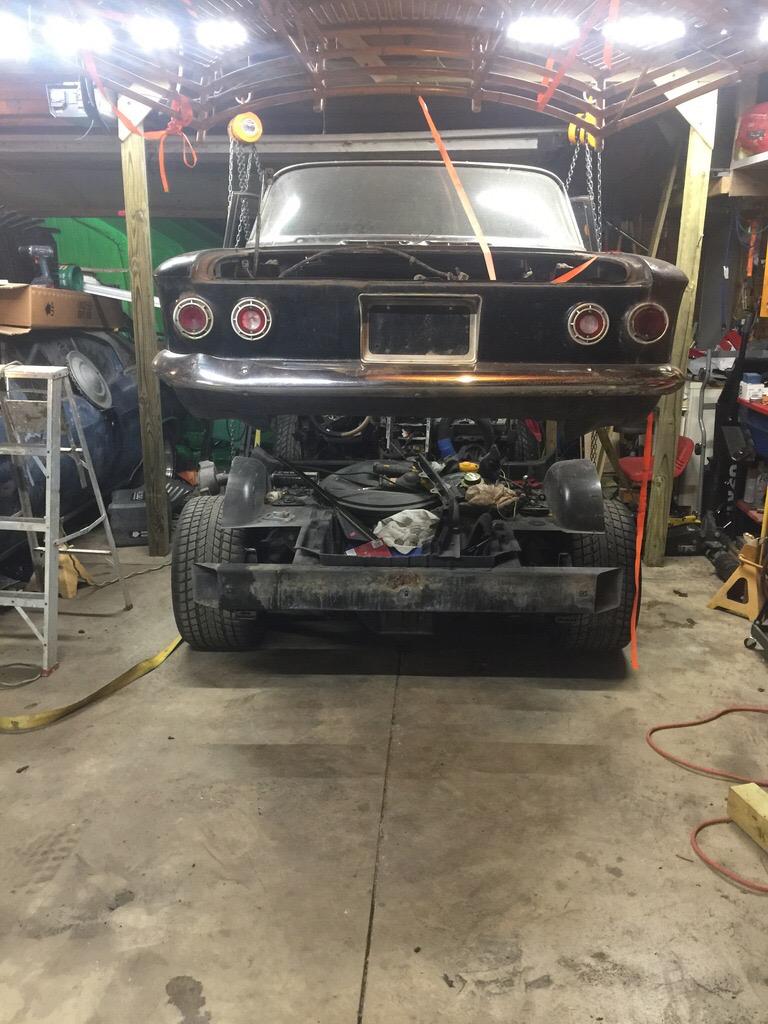

In reply to earlybroncoguy1 :
I have, with a rusted floor corvair and a salvaged c5

An engine swap where the radiator has to be in the trunk looks like a major pain in the ass.

What did you use for half-shafts? Do you have any pics o the rear suspension setup?
