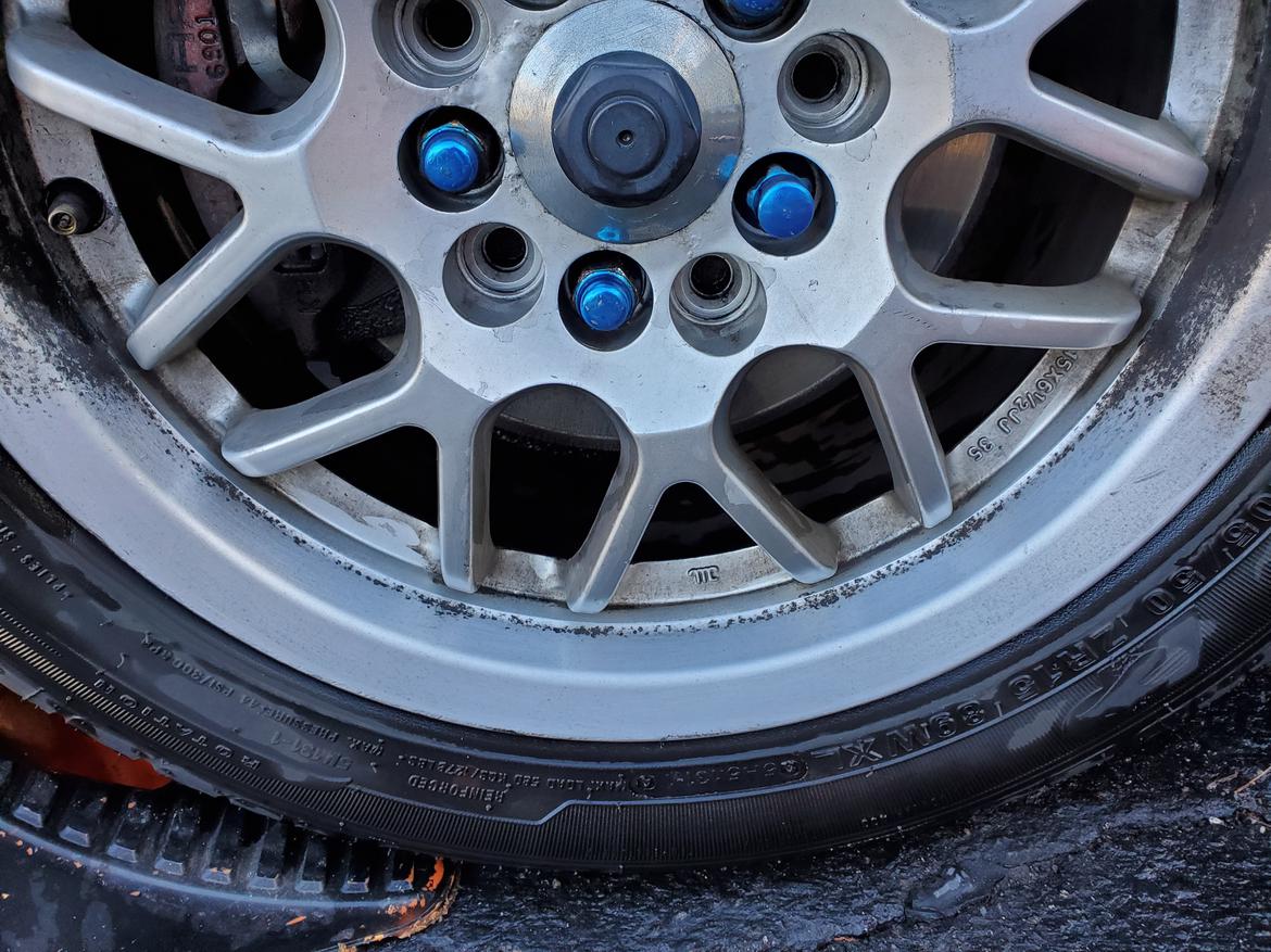

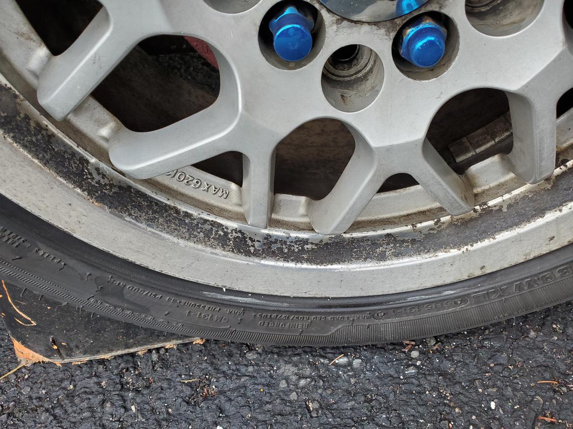

My new Neon project came with two sets of wheels but the ones on the car have a ton of corrosion on the trims.  The centers are in great shape.
Is there any saving these other than painting them or coating with Plasti-dip?
I hit them with aggressive wheel cleaner and then aluminum polish but didnt make much of an impact.  Thank you.

Those are pretty bad. Time to saddle up and paint em

Lots of abrasives, starting about 100 grit and lots of time. You need to do some serious cleaning on them before paint in any case, but no finer than 180 grit. Lots less time and materials.
Dusterbd13-michael
Dusterbd13-michael MegaDork
3/17/20 5:47 p.m.
Id start at 320 grit in a linear motion. Move down if theres still pitting you can feel with a nail.
Move up by 100 grit increments to 1200, then 2000, 3000, and 4000. Then break out the mag polish and a cone.
That will get them back to mirror finish.

I'd say time to dismount tires and have them blasted with glass beads that will remove all current finish and corrosion and give a good surface for paint to stick to. Also give you a good chance to makes sure there are no cracks or corrosion hasn't done irreparable damage.

Are you absolutely sure that's corrosion and not accumulated brake dust? I had something that looked very similar on my Saab Super Aeros, but on close inspection it was clearly raised above the surface. Scotchbrite pads and solvent took it down without too much effort.

I hit it with strong wheel cleaner and a rag.  I wiped it clean and then hit the same spot with aggressive aluminum polish.  The bottom of that rim is the result.  I will take a run at them with scotch brite pads before deciding on a course of action.

The black stuff looks like brake dust.

masonry cleaner may help get lots of that off.  i used sure klean 600, but it is nasty stuff.  use in a well ventilated area and wear gloves and a mask and eye protection.  apply with a red scotchbrite, let it work a little, and then scrub with the same scotchbrite.  rinse with water when you're done.  it helped me salvage a set of BBS RKs that had tons of baked on brake dust that looked like corrosion.  may work for you.

That looks like brake dust. I had a set of wheels I tried to clean the brake dust off and it was brutal. The dust was so caked on I went all the way to oven cleaner, it did dissolve the built up brake dust, but it also took the silver finish off the wheels. I had tested on a small section of one wheel and it took it down to the black base finish on the wheel (Let oven cleaner sit for 6 hours). The biggest problem was lack of space to use any kind of tool, it is all hand scrubbing. This past winter, I ended up hosing them down with oven cleaner and taking all the brake dust and silver finish off the wheels and now have black wheels with out any paint involved, just a LOT of elbow grease. lesson learned, clean wheels often. I think if I had been more patient with the initial products and spent more time scrubbing I might had gotten the brake dust off and not damaged the finish of the wheels, but it would have needed a ton of effort. If your wheels are for winter use or ratty track wheels, clean and inspected them well and just live with them not being pretty.

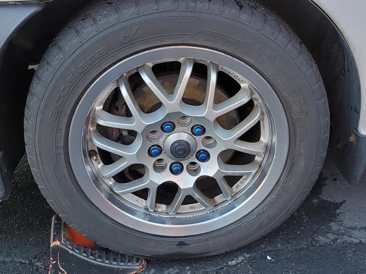

Color me shocked!  I really thought the brake dust had etched the E36 M3 out of these wheels.  I bought some aggressive wheel cleaner and hit them (hard) with a scotch brite pad followed by aluminum polish.  I'll do a better job, but at least this gives me a good sense of what they can look like.  Next up:  rid myself of blue lug nuts!
