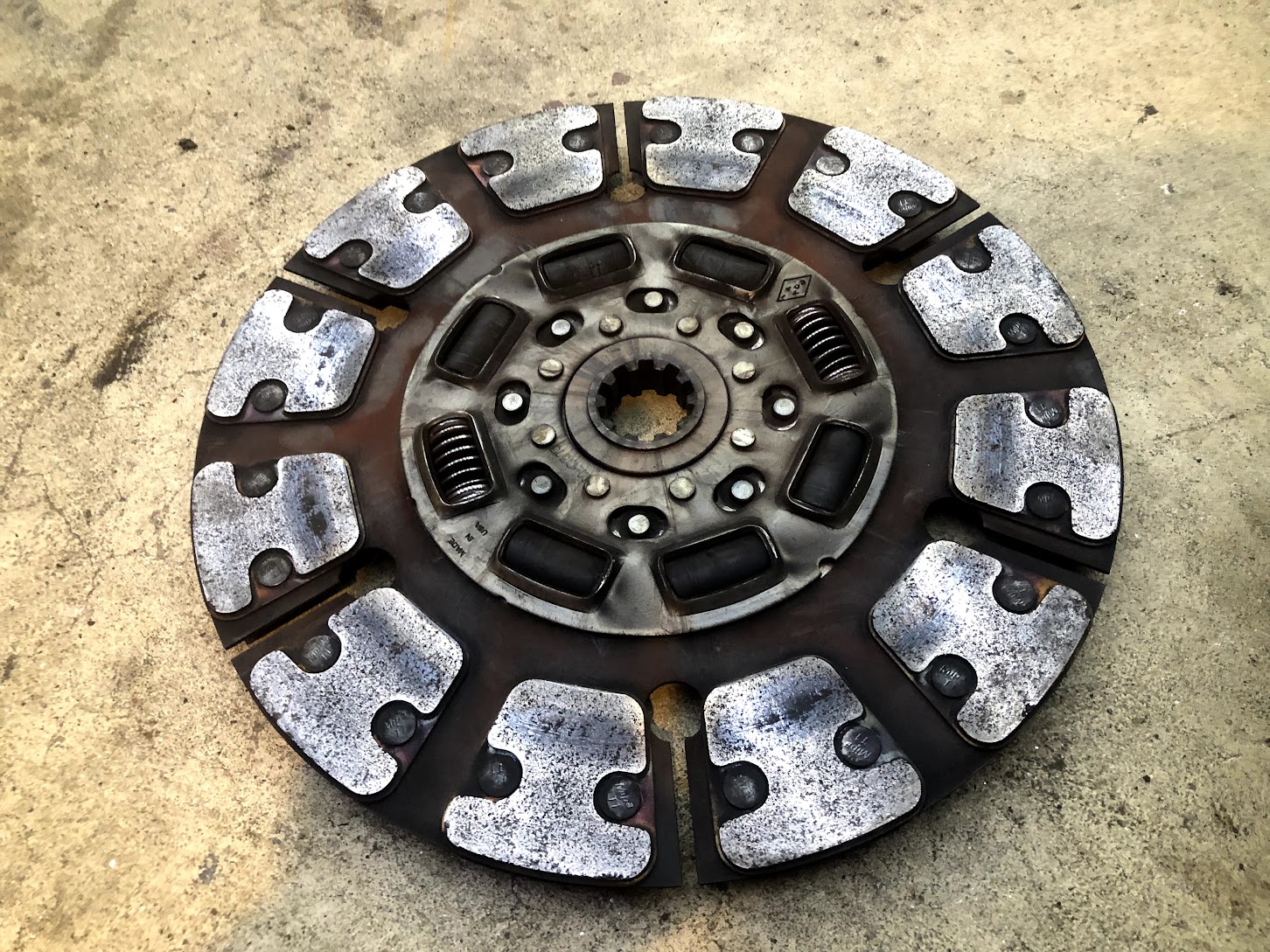

In pulling the transmission, I figured out what the cause of the issue was... Apparently unlike most manuals, this one has a pump and lines running to the radiator to cool the trans fluid. These lines got kinked and were leaking. (Pretty sure before I even got the truck.) Long story short, they were leaking for long enough that it ran the transmission dry. Below you can see the lines, and then the amount of fluid that was left in the trans when I drained it before pulling it. (They are supposed to hold 6 quarts.)
The clutch also didn't look great, and I'm not totally sure why. I did put in a new clutch, flywheel, clutch hydraulics. As well as motor mounts, transmission mounts, new trans cooler lines, new radiator. I was also already planning to replace the water pump, so I did that, the thermostat, and the coolant hoses at this point too.
I did get it all back together and driving. The used transmission seems ok, mostly. It does grind a bit when shifting into 4th, but the rest of the gears are fine. It does whine a bit, but I am going to do some more research and see if maybe different fluid would help that. I have also been noticing the sound that before I thought was the throw out bearing, but now it's a brand new throw out bearing, so I'm not sure what that noise is...  Right now the truck is still on light duty till the clutch is broken in, and till I get a fair amount of miles on this trans for me to trust it. I do have all new ball joints for the front end waiting for me to put in. I'm considering bumping the front end up a bit with a leveling kit while I'm in there. The 2wd trucks sit a lot lower than the 4wd trucks, so it would be nice to get it sitting at a more "normal" looking height.

Driving it around, it's really not bad with the solid disk clutch, I already have solid engine and trans mounts so there's already plenty of vibration. It's good to have the car back.
