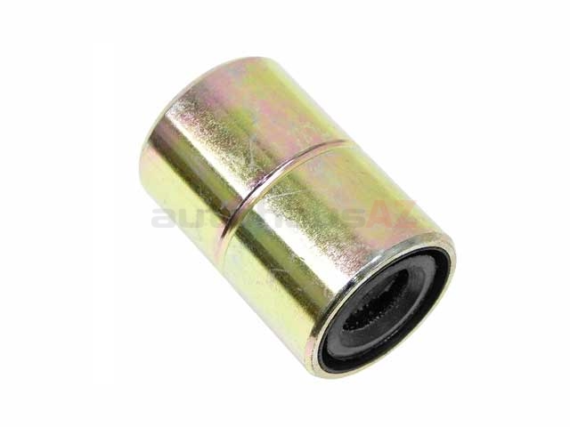

Wonder if it is like the mercedes where they used a centering bushing that is pressed into the drive shaft. The original design only used rubber and would allow the driveshaft to wiggle around creating a bit of a wobble and stressing out the flex disc. There must have been an update because the new design uses a brass bushing and rubber dust seal. A bitch to install, you have to drill a hole in it and beat it out. Good luck, keep us posted! I hate weird noises.

That's what mercedes calls a driveshaft support bearing. Basically supports the driveshaft over the length between the transmission and differential, I had to replace that also. Mercedes uses a centering bushing on both sides of the drive shaft that is pressed into the driveshaft and centers the driveshaft to the transmission output yoke and differential input yoke, looks like this. Good luck Woody, you'll get it fixed one way or the other.
