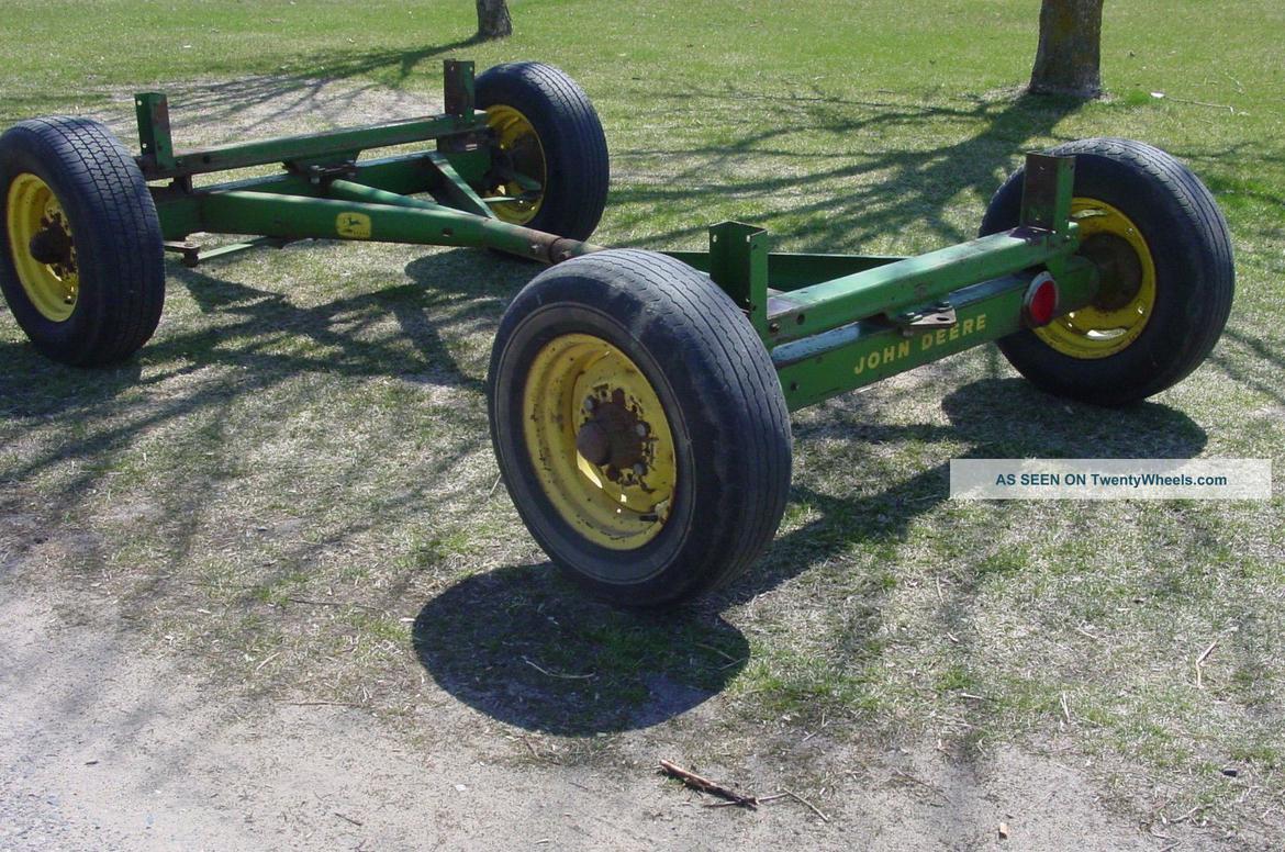

I would use a farm wagon running gear as my starting point. It will cost more up front but if you buy it for a fair price you can resell it for the same amount when you're done.
