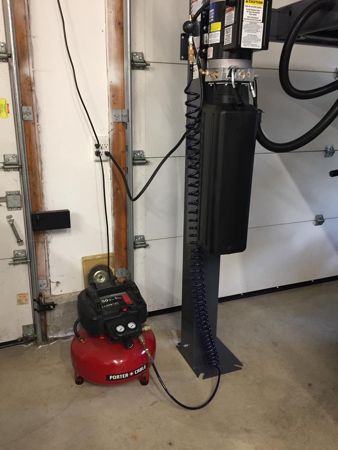

Unless you are going to be putting the lift up and down a dozen times per day, skip the 220 and the air lines.
A small pancake compressor dedicated to the lift will supply all the air that you need for that. I needed a nail gun, and an extra $20 got me a nail gun with a compressor at Home Depot.

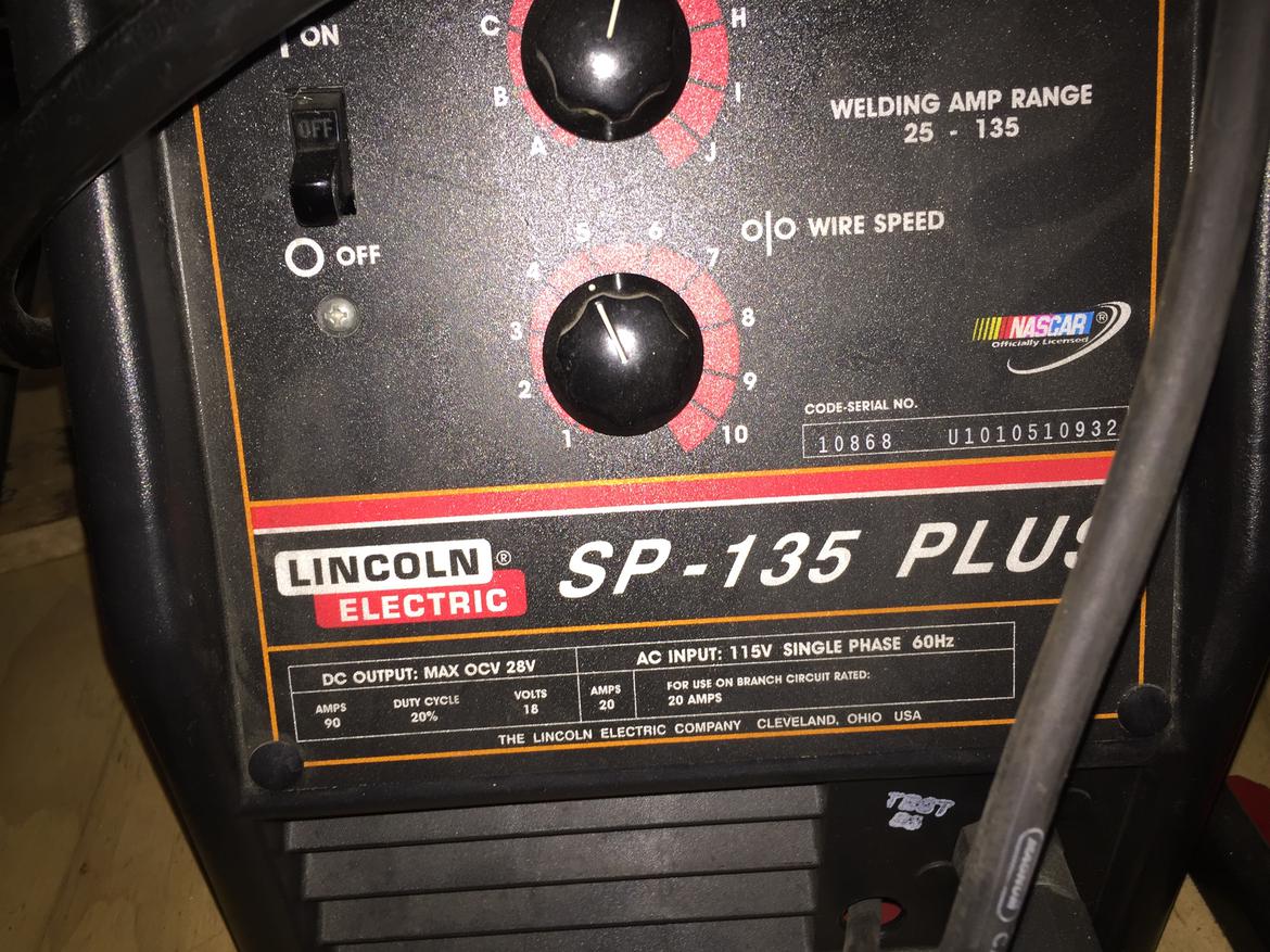

I have a Lincoln SP-135 Plus that meets all my welding needs. I'm not building bridges or even heavy trailers.
Painting CFM...well, I can't help you there.
Would 220 be better? Sure, but I get a lot of work done with this setup.

A pancake compressor will run the bendpak lift itself just fine.

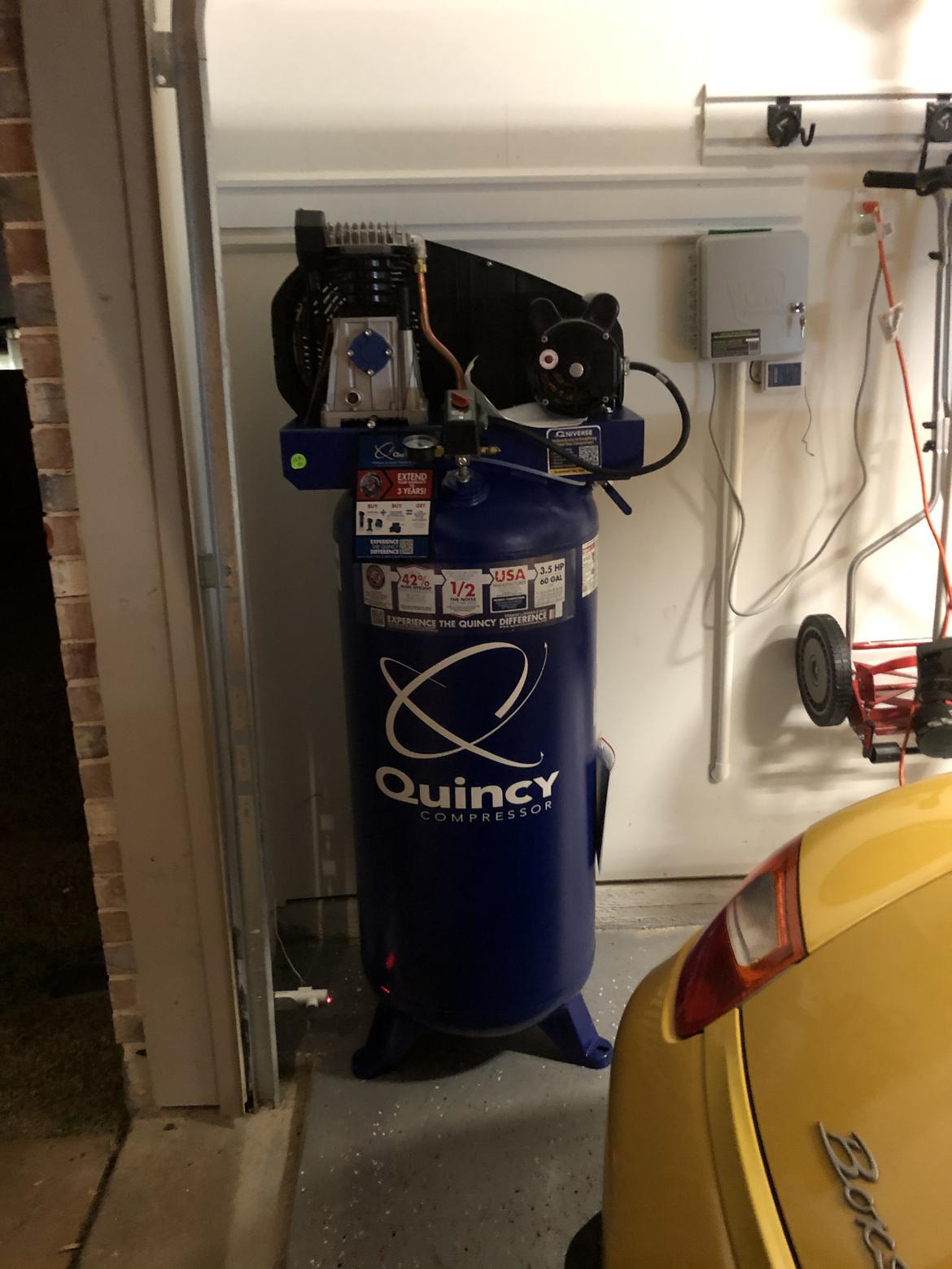

After consulting here and garage journal (read there and don't post), I ended up with a 60 gallon quincy Q13160QV.  It'll make 10 cfm at 100 and 14.6 at 40 psi.  The paint guns I'm looking at need 10.5 cfm at 40 psi.
I also got an install kit ( steel braided hose and mounting pads to regulator ), a regulator, and a 50 ft hose reel.  I will drain the tank manually for now but may add a separator / filter too.  I ran compressors on the sub, so know a bit about this stuff.  I also got the maintenance kit to get the 3 yr warranty on pump and 2 on everything else.
Next up call electrician and get garage wired for 220V times 3 machines.  I figure I can do it on 2 circuits with NEMA plugs.  I won't ever need all 3 (lift, conpressor and welder at once).
This may be overkill, but I will never need another compressor and I have 12 or more years in this house / garage to go.
