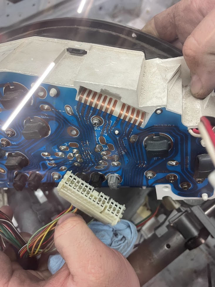

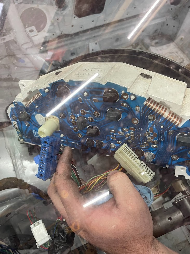

Hey all, got another wiring issue that I haven't found anything definitive online yet.
So the harness is a 95 AUTO, pulled from a car, but the gauge cluster plugs don't match my cluster... Now, it is very possible that the cluster I am messing with now is not the one from that 95 auto car. So, is it an Auto/Manual thing that makes the plugs different? I have 2 clusters exactly like this that don't match up. If the auto is different I have to assume I have the auto cluster burried in a box somewhere.

Those aren't the cluster plugs. All NAs used the same plugs for the cluster - and IIRC the NB used them as well with a third one added.
Since I don't recognize them, I'm going to guess they could be to the transmission control unit- I don't mess with many autos and I don't even know where the TCM lives. I don't have a '95 wiring diagram available to me at the moment. One of the guys at work might recognize them.

In reply to Keith Tanner :
Ok thanks. Guess I'm just blind and need to find the correct plugs in the harness.

Ok, yeah. It was me missing the obvious. There's wiring still attached to the one dash I had sitting outside. Guess the dash kinda has its own sub harness.
