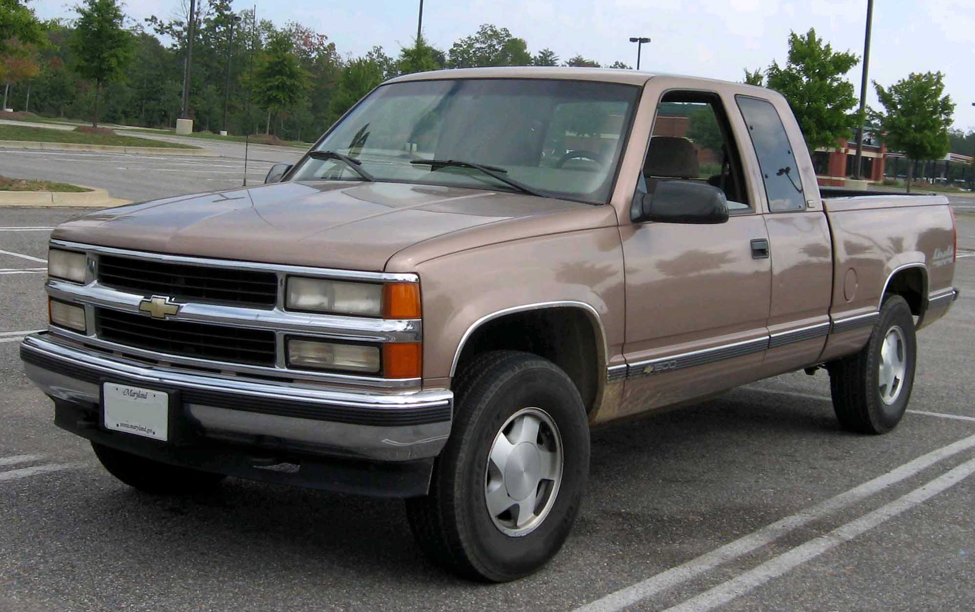

A fellow from another forum came to collect my car yesterday. With my project out of the way, an a move to Kelowna coming up, I'm thinking of getting one of these.
An extended cab GMT400! I know they're not the fastest, sturdiest, best looking or most capable truck out there, but for $4000, they're bargains. Are there any GMT400 owners on here? If so, what should I look out for when buying one?

Look for excessive frame rust, brake line corrosion and clean all grounds for starters. Well, in the NE anyway.
8/17/15 12:14 p.m.
Cab corners like to rust out on them, but, hell, they're all close to 20 years old by now. Looks good from the pic.

Pretty much the same as my '99 Suburban. The 4L60e is a known weak spot, don't tow too hard with that and use drive when towing or around town instead of OD. The brake hardlines can pop if corroded. The rear brakes are drums and require special drum brake monitoring (cylinders/adjustors/etc). Use AC Delco plugs/wires/cap as other brands don't seem to play as well with the GM engineering.
Otherwise, it should run forever and be reasonably comfortable doing it.

They're either rusty or going to be.

Cab corners and areas over the rear wheels like to rust. 700R4 not the strongest transmission around. Others noted additional areas to check for rust.

it's been said over and over, but it bears repeating. the extended cab corners seem to fall off these things in northern climates. Look for rust, as it's one of the most costly and time intensive things to repair properly.
2wd or 4x4?
Are you looking at that specific one in the picture?
The '94+ models got the newer front fascia with the more bulbous grill.
The '95+ models got a new dashboard which had a more tradition center mounted 1.5 din Radio location (the earlier 4th gens have a goofy cluster side radio), and an updated interior.
Around '96 the engines were upgraded to the "Vortec" engines instead of the old TBI setups, and all used the 4L60E's which do wear out, but anybody/everybody can rebuild them.
