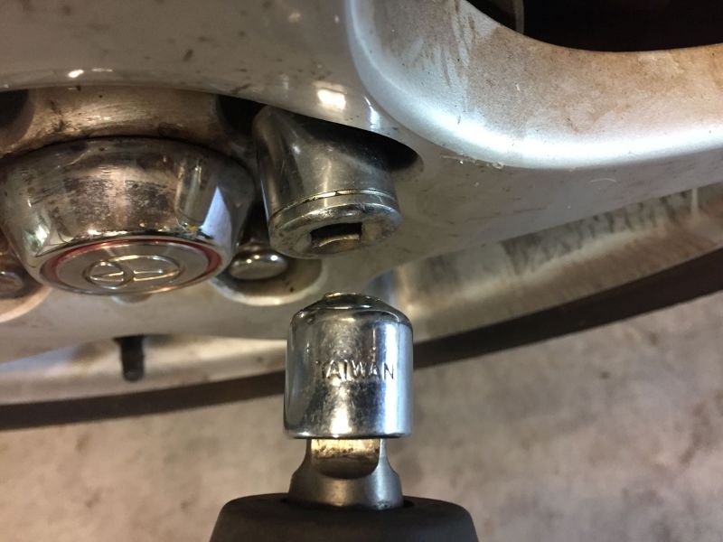

Well, I decided to try the "hammer a sacrificial socket onto the lock" technique. I found a 3/4" 12-point that fit really tightly and drove it on solidly.
It was 3/8" drive; I don't have any 12-point 1/2" drive. My 3/8" impact isn't stout enough to remove a lug nut so I switched to the 1/2" with a 1/2" -> 3/8" adapter. Well, that didn't work well.
I think you see a key word there that explains why the failure was that fast. Anyway, I now had a socket firmly wedged onto the lug nut and that socket had a broken off drive pin stuck in it and I had no way to grab it. At that point I had to break for the day - my 45 minutes was up. I got back to it tonight after putting the kids to bed. A hole drilled in the middle of the socket drive pin and a sheet metal screw driven in a tiny bit took care of it.
I tried a 3/8" breaker bar and that just worked the socket loose. Next! I tried grinding the chrome off the locking lug nut and welding a sacrificial nut to it.
In the last pic you'll see the nut is glowing nice and brightly. But I just couldn't get enough penetration on the weld to the locking lug nut; my weld kept twisting in half.
I decided to use my grinder to cut a slot in the locking lug nut and hammer on it with a chisel. Success!
The wheel is a tiny bit worse for wear. I had hoped to get some money for the wheels - not much, but maybe $150 for all four or something. I might still be able to. The center cap got a bit of weld spatter damage but overall the wheel itself is still nice. It's after 11 so time to clean up. Remember - no more leaving tools and crap all over the work bench!
