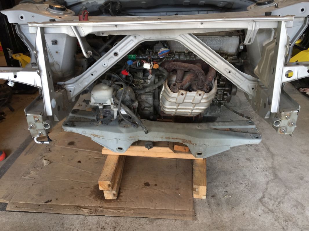

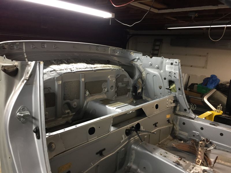

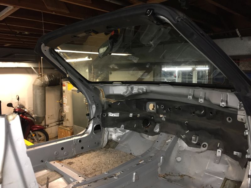

OK, I didn't make my last Monday deadline, but as of last night the shell is stripped to bare.
I started by stripping the insides, then moved on to the suspension and motor/trans combo. There is a LOT of wiring in a modern car, and Toyota doesn't make it as easy to pull engines/etc as GM does. GM gives you a nice big plug or plugs right inside the firewall; Toyota buries them a bit. I'm a little worried about how this is going to go when I plan to reassemble the vehicle. But it was straightforward enough when not planning to put the car back together.

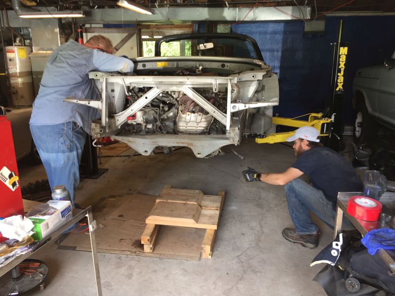

Pulling the motor was fun:
Note the high tech cribbing. I pulled all wiring, suspension/axle parts, drained coolant and disconnected those hoses (man that was a joy), then undid the transmission mount. After that the mounts are easy to get to with the car on the ground, so I dropped it until the engine and transmission were supported by the cribbing.

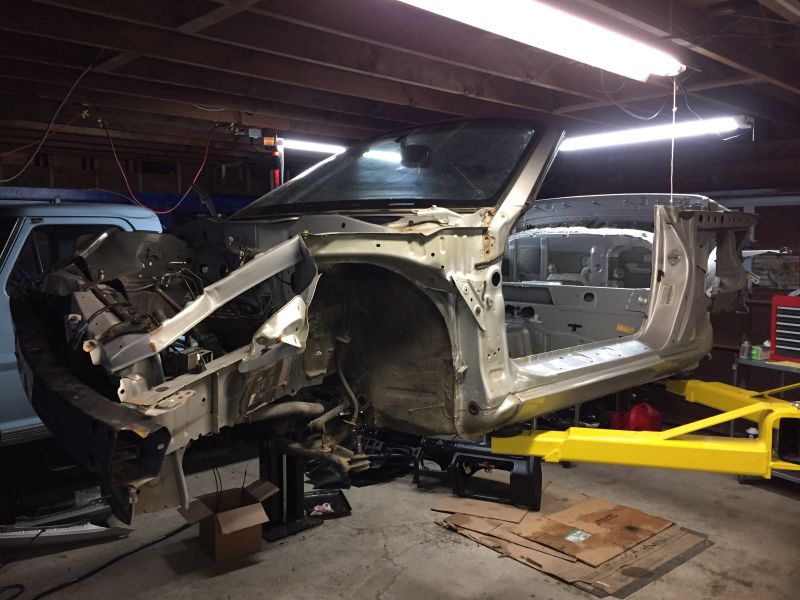

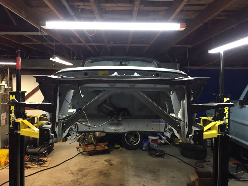

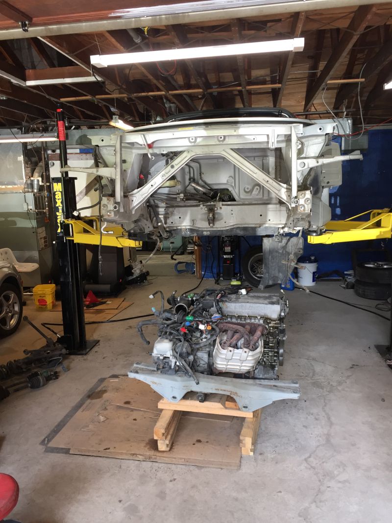

Then I undid the two side mounts and the four bolts holding the subframe on. The next step was lifting the body off the assembly; it went easily enough. There was some risk of damage from the oil dipstick hitting the body, but at this point the body was light enough for me to pick the rear end up and move it over and inch or so on the lift before continuing. That was pretty fun!

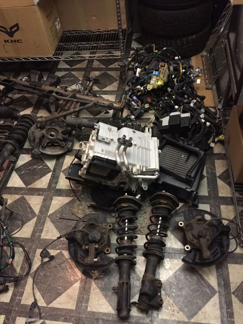

And we're clear! No more engine/trans in the car. A couple more hours zipping out bolts and I had a pretty impressive pile of parts built up:
Now comes the less fun chore of cleaning, photoing, listing, and shipping this stuff. That's all straightforward and I've been down the road a thousand times, but I need to keep moving on it more than typical since I want to clean the space back up for more fun stuff.

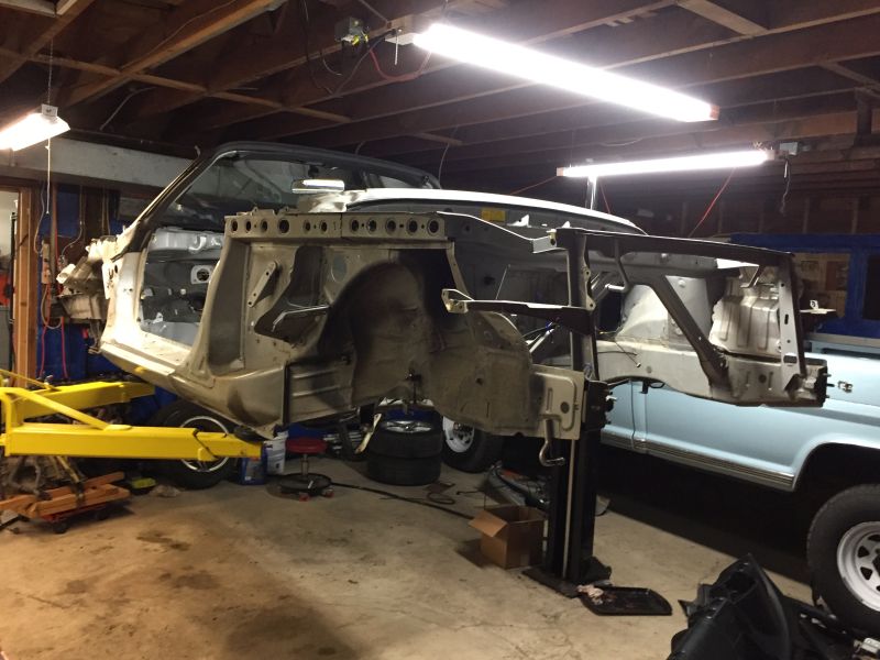

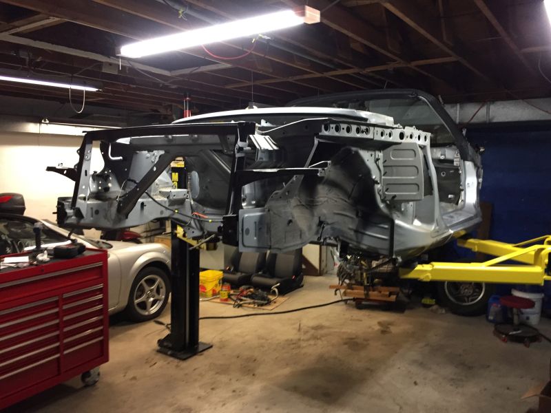

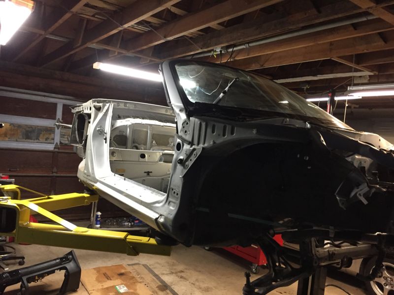

And the shell, which is probably going to get a sawzall job (to make it easier to load in the truck) and sold as scrap metal:
Not much left there!

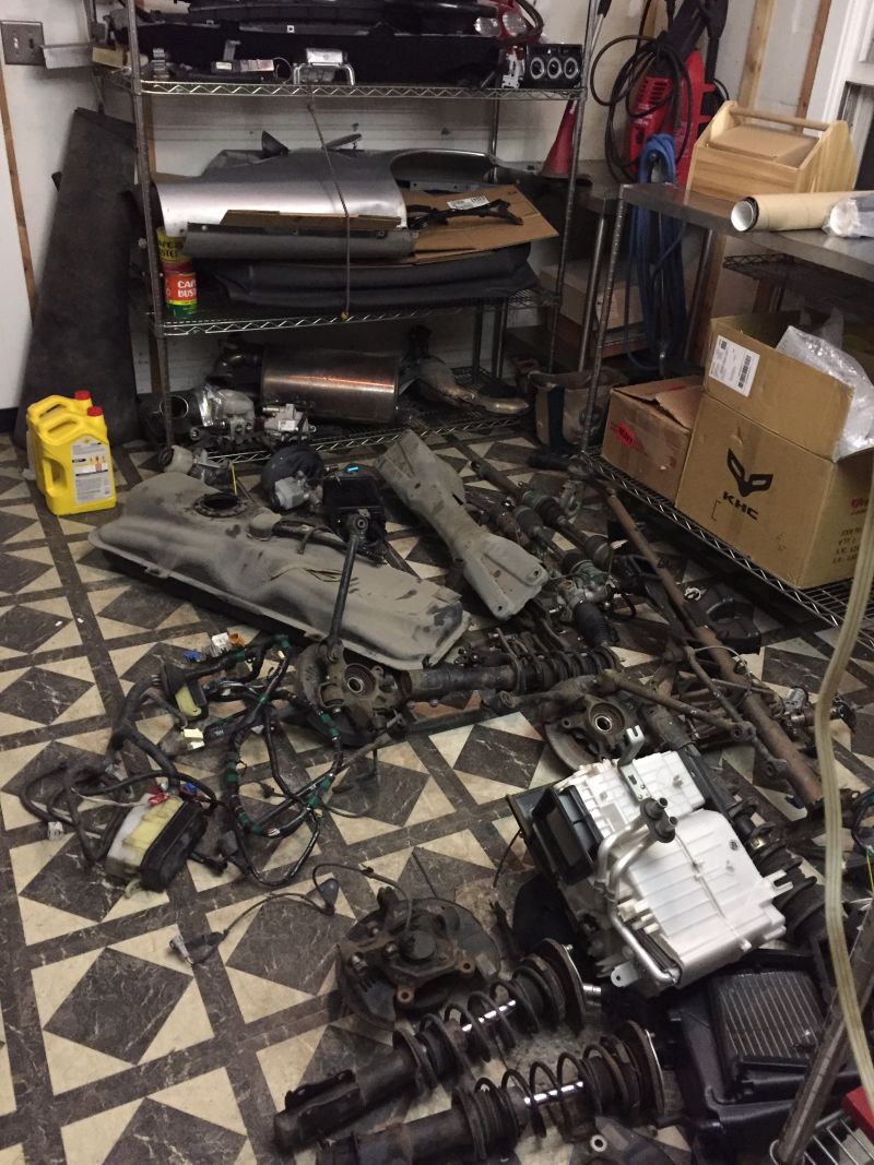

I don't know if I went over my method for listing items. I know I talked about looking at completed items on eBay. Well, I look at those and see what's sold and for how much and make a spreadsheet listing approximate values of each item. I then sort by most expensive and list in that order. It's easy to get bogged down in details and listing every little $10 trim piece or $5 bracket. I skip all that by refusing to list anything valued under $50. Your own cutoff might be different, but I've decided it's just not worth selling an item on eBay if it's worth less than $50. Now - sell locally or to a GRM member? Sure! But if I need to pull the item, take pics of it, list it on eBay, wait weeks or months for it to sell, and then lose 10% of the value to fees and ship it - it's just not worth it for a profit of maybe $3. Listing and shipping a $5 item takes just as long as listing and shipping a $500 item.
With that said, I start with a pile that looks like this:
and pick out the stuff I want to sell, one at a time, and quickly clean it and photograph it then put it in my "eBay inventory" area that currently looks like this:
Then after I've photographed and organized enough items - which is highly dependent upon my level of alertness since this all tends to happen at night after the kids have gone to bed - I list the items on eBay. I used completed and current items as pricing guidelines but sometimes will vary from them based on condition or how badly I want to get rid of the stuff.
