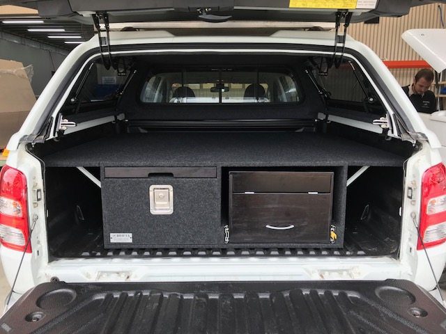

Bit of background: I'm commencing a build of an enclosed 6x4 trailer into something more user friendly for when my family and I go camping. I want to build a set of pull-out drawers to store items in similar to the pics below.
