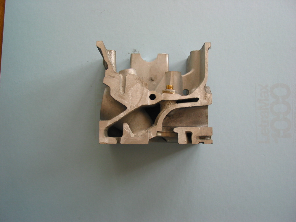

You should plan on getting rid of the heads.. Start watching either for an earlier (1971-1980) engine or just the heads.. There is real power there compared to the H.E. heads that you have.. I've bought whole engines for as little as $50. but $300-$500 is the going price.. The real bargains are engines with problems.. Don't worry if it's seized up. You're going to take it apart anyway..

BMW learned from Jaguar.. In 1981 Jaguar adapted the May head (and called it their H.E. engine).. The real benefit was pollution was seriously reduced and would meet the new California requirements.. Otherwise Jaguar was going out of business.. The loss of sales in California would have killed the company..
Anyway May really didn't originate that combustion chamber shape.. GM did in the 1940's. It was called the Fireball Head.. By swirling the intake charge over the hot exhaust valve a leaner mixture would fire without the stumble common with lean mixtures.. Chevy called it their Fireball Head and that's exactly what May called it when he sold it to Jaguar..
As far as real world use, the BMW like Mercedes Benz and Jaguar before with V12's are thirsty engines. Basically 1&1/2 times a similar V8 But they have a lot of Torque at low RPM. Perfect for use in heavy sedans filled with Plump Germans and their golf clubs.. Not to mention an incredibly smooth engine due to the firing order.
Since BMW lacks the flat head option of the Jaguar power will be down unless you can find the extremely rare all out race heads they made.. That plus The BMW isn't going to be as easy and cheap to significantly increase the bore and stroke like a Jaguar..
You are right though, Turbo chargers cause those issues disappear. And since BMW doesn't have a distributor you are left with an aftermarket Computer system to develop..

I was under the impression that with forced induction, induction/exhaust layout and chamber design were much less an issue. I have located a pre HE engine but here the price is higher $650-700. Is it worth the extra cost for how much power? I'm not beyond spending the money, just want too spend wisely. Max bore size, induction mods, aftermarket cam and springs, and foolproof ecm/electronics are part of the plan. I am I being too cheap on the heads or will they provide significant power improvement with forced induction? Looking for your thoughts.

The difference in power starts out at a minus 25 for the flathead. That's due to a 7.8 compression compared to 11.5. The H.E. head was designed to meet smog emissions and as a result hurts performance.. Once you start to modify the engine power output clearly favors the earlier head..
Toss a turbo on the H.E. head and a turbo on the flathead and the H.E. even with reduced compression will run hot, blow gaskets, and burn pistons and valves.. Meanwhile the Flathead will make about 100 horsepower more, and suffer from none of the issues the H.E. does..
You want the H.E. engine because the advance profile works better under boost than the Flathead does, plus it's got either a much better transmission than the flathead does or it's that much easier to swap a manual transmission onto.. But you want the flatheads for power output and reliability. So bolt the flatheads onto the H.E. (they fit!! but you can not use the H.E. pistons). The stock springs will be tired and will not work well under boost. Get your springs from ISKY camshafts..

Dear frenchyd, how do I recognize an early head if it is on an assembeled engine?

Robbie wrote: Some porting would help, no doubt, but that pinched angle is rough. I actually think the m70 or m73 would make an AWESOME boosted setup.
Looks like plenty of opportunity to port, weld, and reshape to minimize the angle. Wonder why that wasn't done from the factory?
