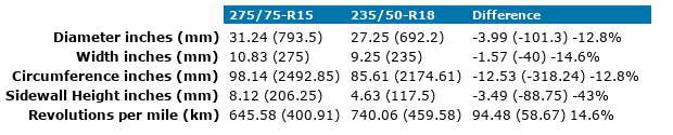

So I just ran the math on putting these wheels on it. I thought it would be funny.
They're 18x10 aluminum, 275 35 in the back, 235 50 in the front. 27.25" total diameter, which is 4 smaller than the 31's on the ranger. Here's why it's a terrible idea.
So, any summer or highway tire recommendations, since it now looks like I need to buy some? Preferably 15"
