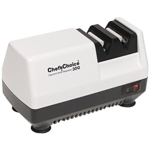

The shop I work at sells Benchmade Knives, which never really need sharpening and if they do, they do it for you. Also, we have a few sharpeners sitting around for the other knives we sell. Kabar and other cheap eye candy.
Something like this is what we use. In fact, this might be it...
