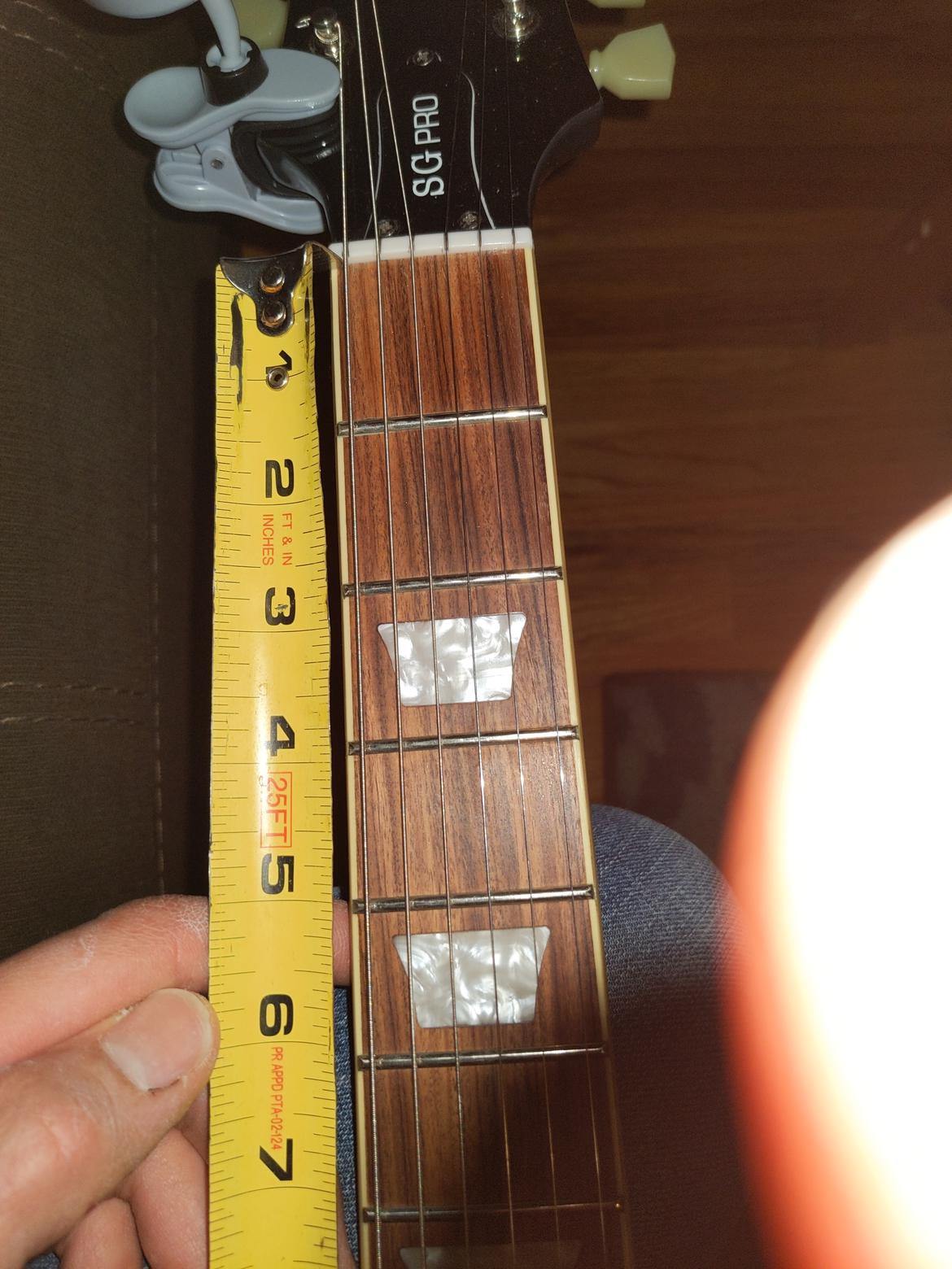

In reply to tuna55 :
It's hard to tell from your picture, but you need to hold the tape measure against the fretboard side of the nut and then measure down to the bridge.
On a Gibson type guitar, it should be roughly 24 3/4" on the high E, with the thicker strings being a bit longer.

The nut is on correctly. Thanks, I didn't think of that.
The picture there is with the tape on the other side of the nut. Here's the other way.

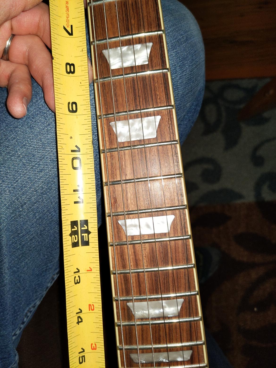

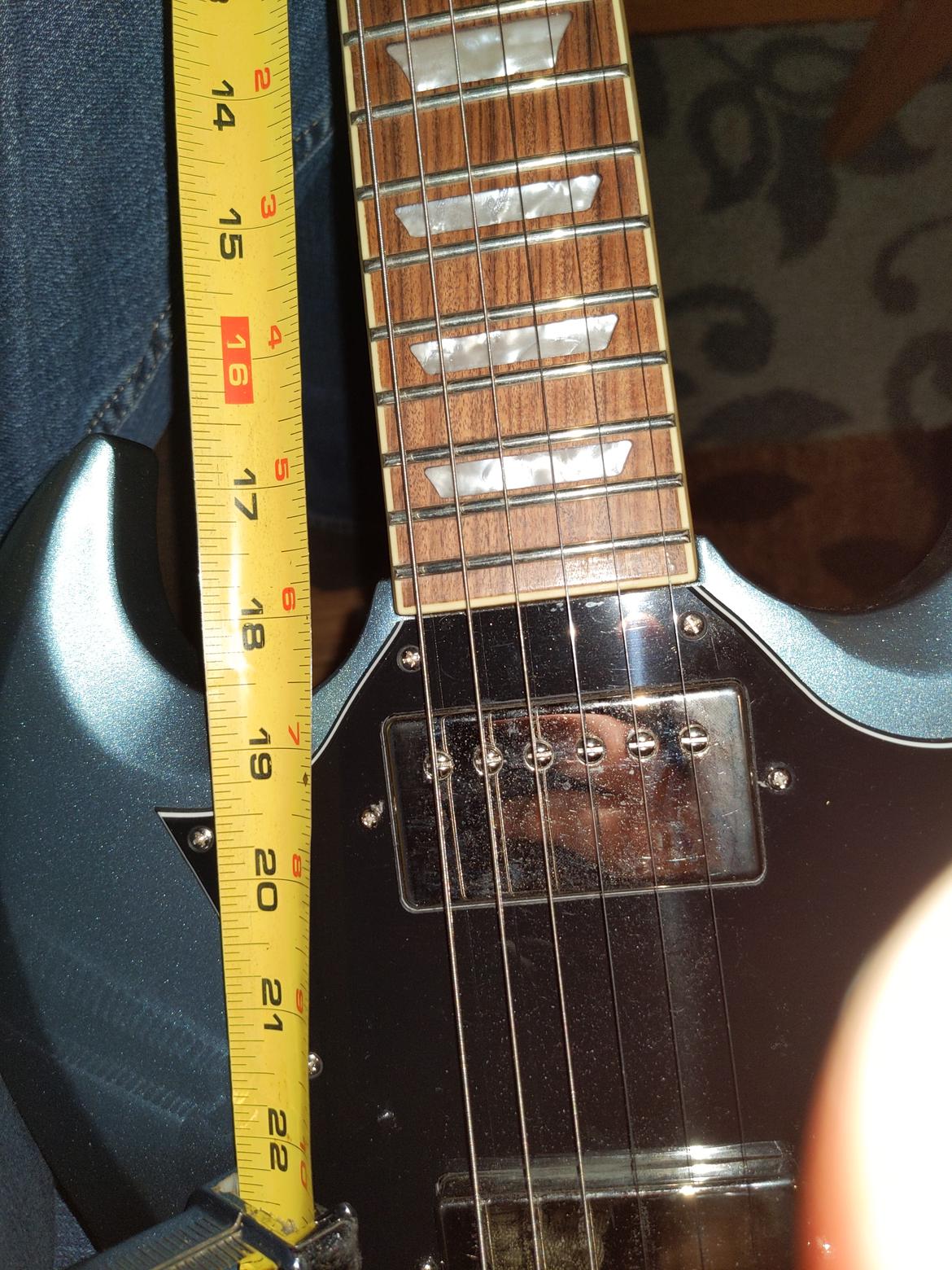

The bridge appears to measure correctly, but somewhere around the seventh fret our measurements begin to diverge
1/31/21 6:14 a.m.
One thing I haven't seen mentioned is the fret crown. Fret wire is semicircular, the tops of the frets are then filed flat to ensure they're all level. After that they're dressed with a concave fret file, which narrows the flattened crown of the fret to bring the intonation back to spec. I presume that's all done by machine on your guitar, but if for some reason they missed the 7th fret, or the file was misaligned, it could cause your problem.

Thanks everyone. I am bringing it tp UPS tody (and letting them pack it) and sending it back. Nothing I tried made any sense. Time to bail.

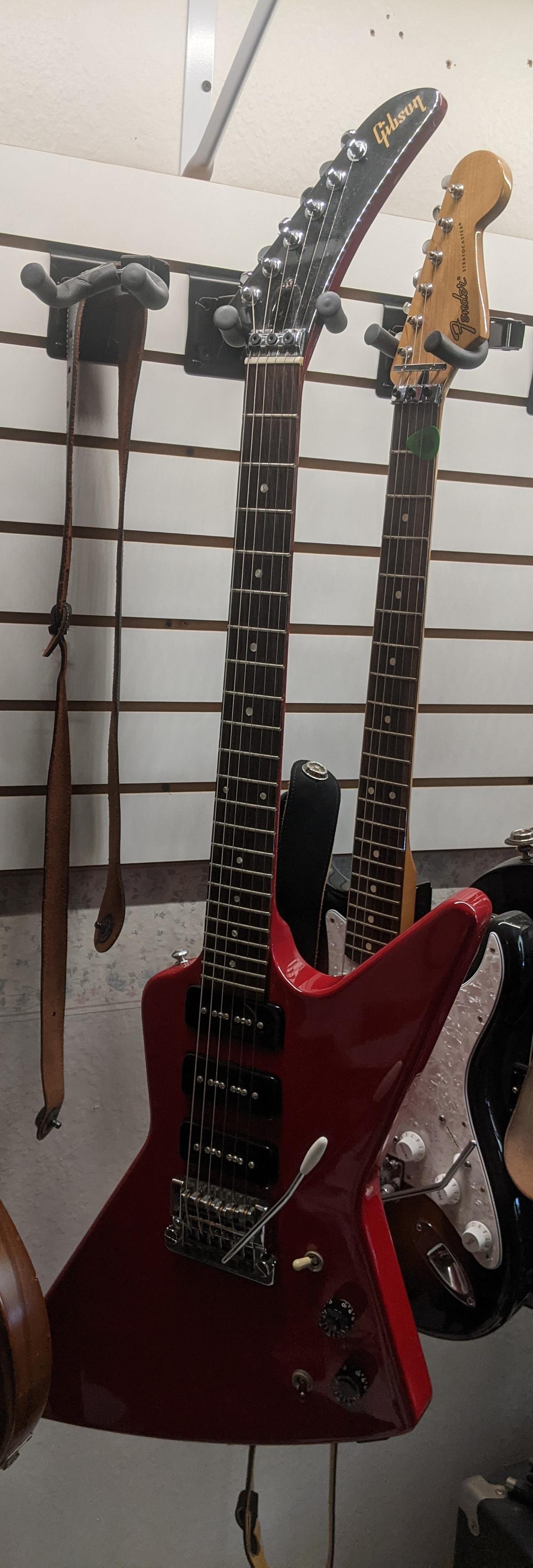

That said, I've been looking at a '84 Explorer on Reverb for awhile and was pondering making an offer. Then last week the seller dropped the price into my offer range, so I pulled the trigger. I've been wanting a P90 equipped guitar for awhile. And I like Kahler bridges.
Tis Ferrari Red.

Yeah, that's the stuff. Triple pickup Explorer with a Kahler? Sign me right the berk up for that! NICE SCORE!
