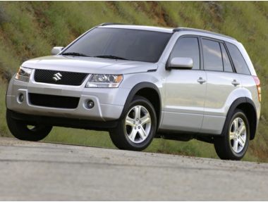

Related to this short lived version of the Suzuki:
No relation to the more popular Suzuki:
