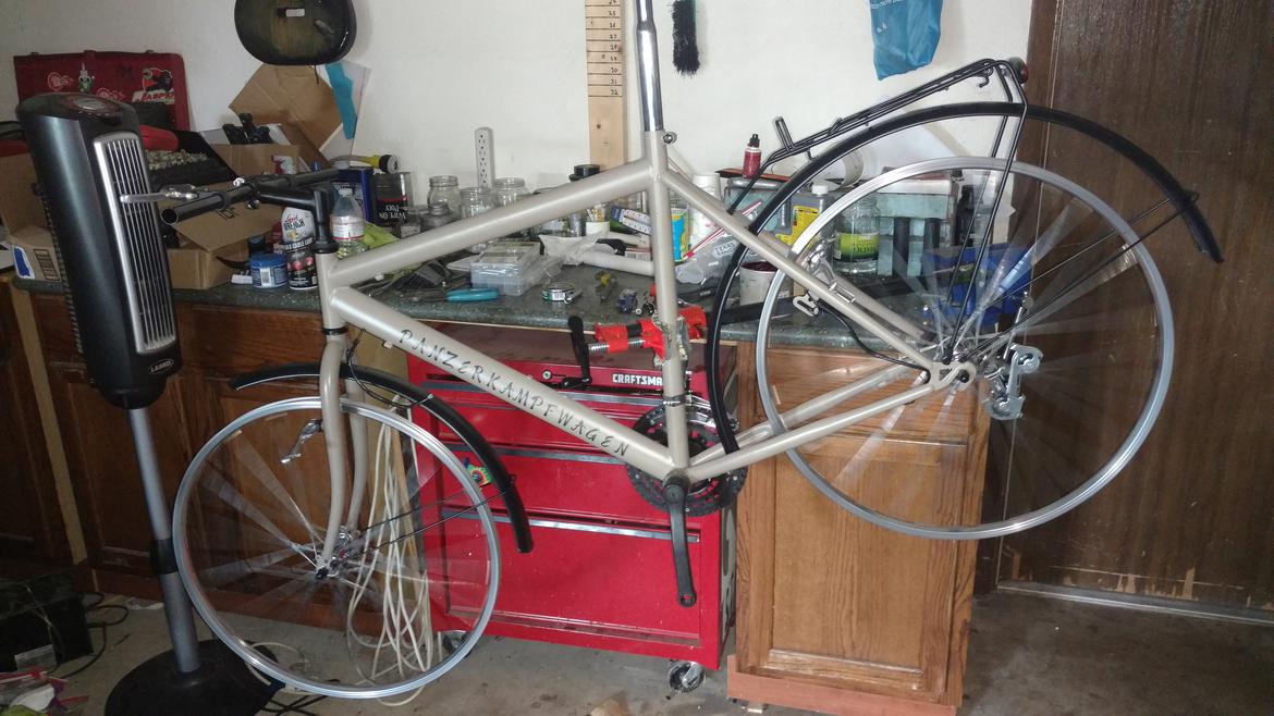

8/26/18 7:05 p.m.
Spent the day polishing out the rims spokes and hubs. They cleaned up decently well. I contemplated painting them black but decided against it.
After new bearings and getting the axles back in place I retentioned the spokes and trued the rims. Only broke two of the original spokes. Thankfully I had some spare spokes and nipples left over from the green bike that were the correct size.
I'm going to tie and solder them just have to pick up some flux and wire.

Tied and soldered the rear wheel. Probably won't do the front unless I run into trouble down the road.

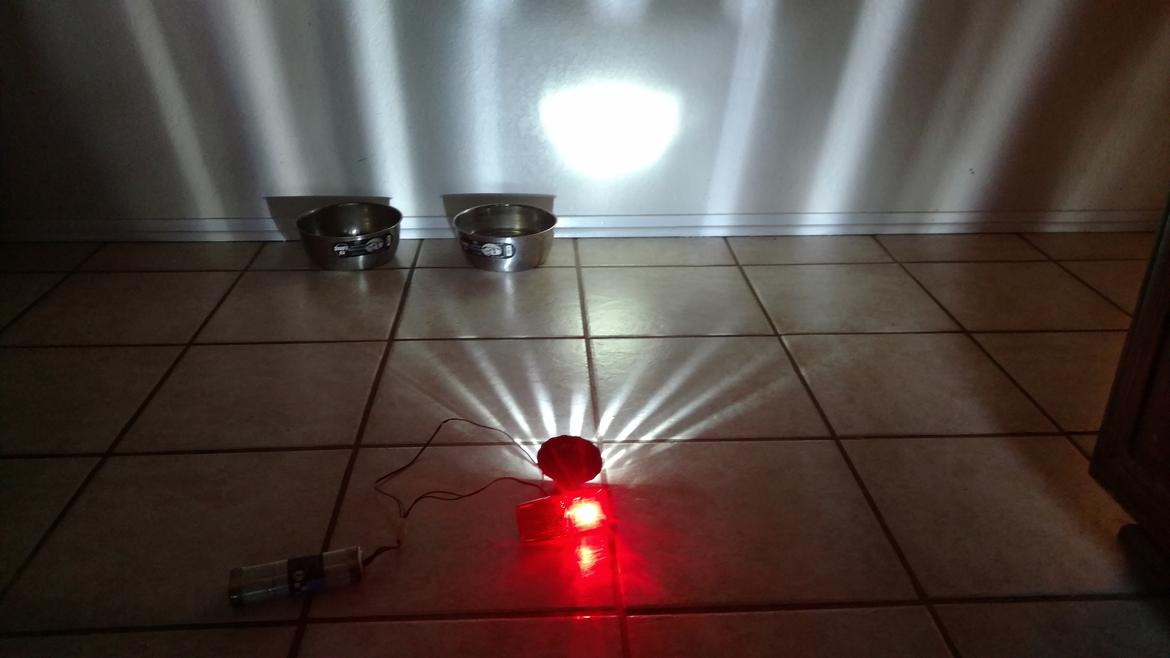

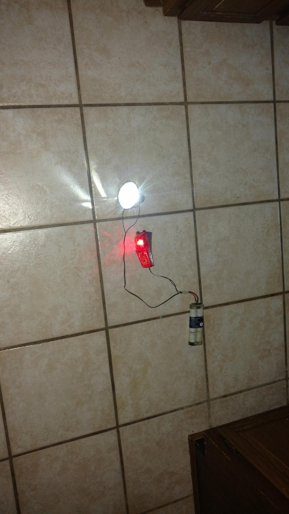

After some consideration and some input from bikeforums I've decided that instead of upgrading everything all at once I should put it back together the way it came and actually commute on it for a while. In particular to get a feel for the gearing that I would typically run. So I cleaned everything, installed new bearings and put it back together. I did change from caged bearings to loose in the headset and bb.
Things that I'll need to purchase to get it back on the road. Tires/tubes, shifters/shifter cables, pedals, grips and a saddle.
I was messing around with the lights. Standard 6V 3W headlight, LED rear taillights and a little bottle type Dynamo. I really didn't like that Dynamo, too noisy. As the headlight uses just a standard flashlight bulb and LED retrofit bulbs are readily available I picked one up and switched it out. The new bulb is good for 9V. I remembered I have a 7.2V battery pack for an old remote control car so I charged it up and tested it out.
It's been running steady for a little over six hours now. I think this is going to work out okay.
I'm going to pick up a small waterproof box that the battery will fit in and mount it to the mounting location in the frame for the bottle generator.
