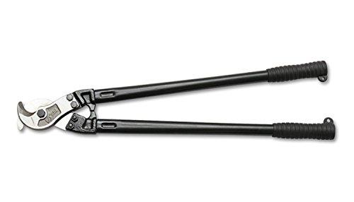

even local shop thought this was cool... after i showed them... mark the area where you want to cut with a sharpie..  then dribble some super glue on to the hose,, where you want to cut it...wrap this with electrical tape.. then get your hose cutters( the one used for cutting this type hose )then cut the hose.. unwrap the tape.. and will see there is no flairing of the ends of the braid ..this does not affect the hose at all. and makes it easier to install the A/N fittings.
