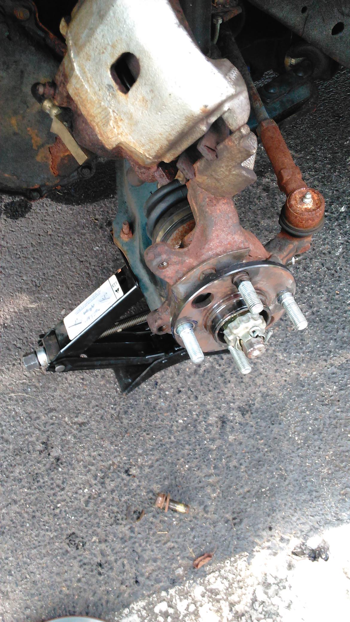

The fact that it was an old stud would make me continue on the journey, as well.  Can you post photos of the threads on the broken studs, as well as the broken area itself?  Sounds like they were overtorqued to me.

So, I replaced the broken stud, took it on a test drive around the block, pulled it back in to retorque the lug nuts....snapped another old one by hand.
So....I have enough studs to replace all the old ones and I'm obviously gonna have to do that. It's slightly a bitch punching them back in, I'm pulling them in the last bit with a sacrificial lug nut and a wrench to space it.
I'll go down in a sec and grab an old stud Cooter, but broken or not the threads look undamaged

Got up early and did the studs on the other side. The one the shop replaced isn't exactly right and he wrapped them in electrical tape to make it snug. I'm not sure it super matters but I'll have to buy another stud and I think I'll replace it too. Remember me saying I never have good luck with someone else working on my stuff?

californiamilleghia
californiamilleghia HalfDork
7/7/19 9:18 a.m.
one the one that the other guy replaced ,
one mine the old bolt had wobbled out the hole  so it would not come off without an air impact ,
putting it back together we needed to weld a few tacks so it would not spin and could be tightened up ,
might be why the tape is on there......
Antihero
Antihero SuperDork
7/7/19 9:29 a.m.
You are probably right, although it is tightening so far
