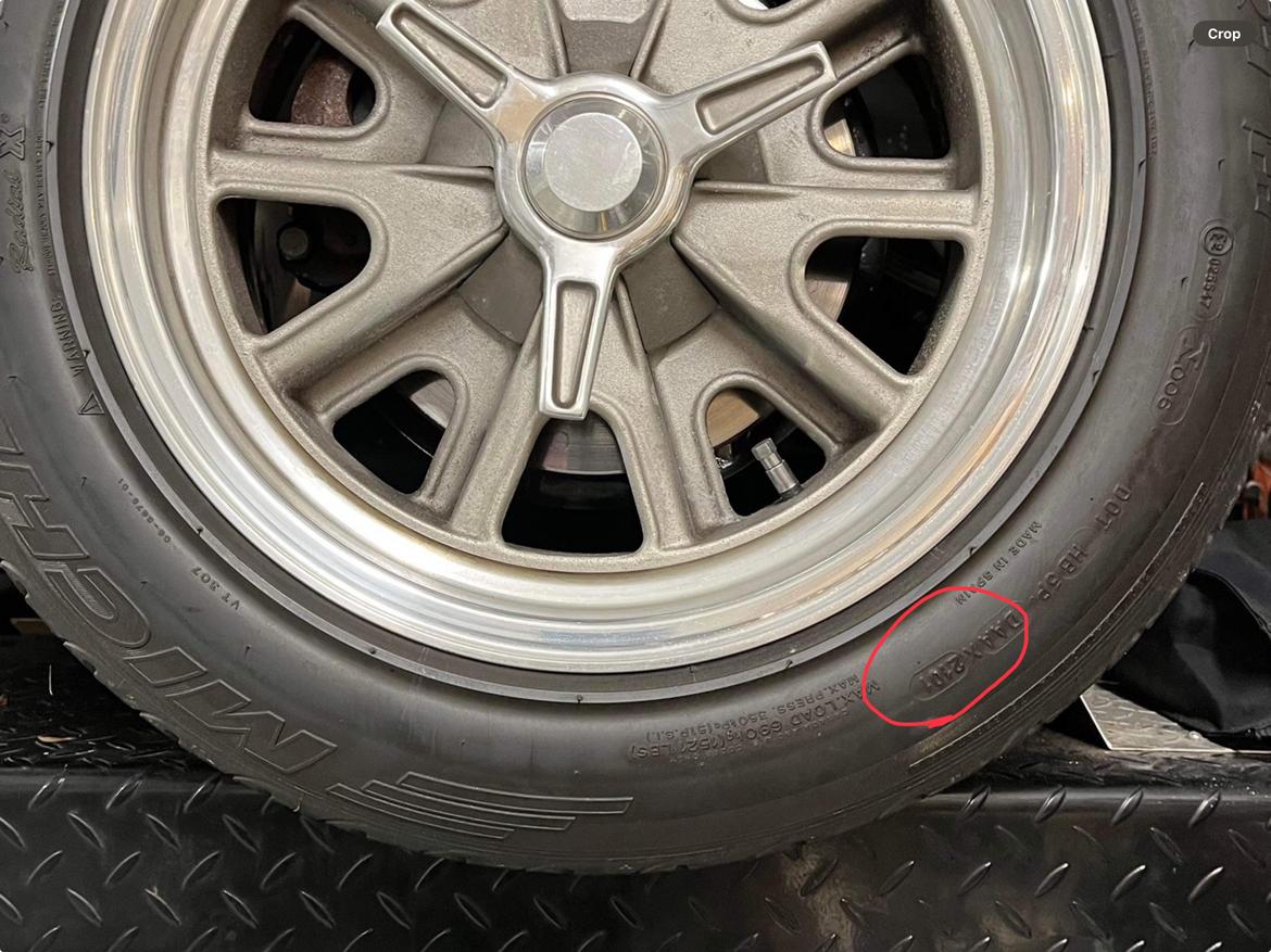

So, how do you know when your tires were built? Easy: The date of manufacture on any DOT-approved tire is embossed into the sidewall.
Since the year 2000, the last four digits of the tire identification number represent the year and week the tire was made. For instance, if those numbers are 4818, then the tire was manufactured the 48th week of 2018.
What if you only see a three-digit date code? Those tires were built before 2000. Do not pass Go.

I just bought a '72 914.  The tires looked really good, no tread wear, no flat spots no cracks or dry rot.  They are Michelin tires and I went looking for the date codes.  1989😳
May of 2001.
