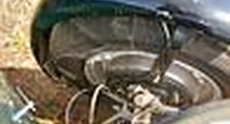

more on the front fenders
Here’s a second shot of the fender carrier.
Jan. 26
articulated fenders
Basil: The supports for the front fenders are attached to a carrier that sits behind …
