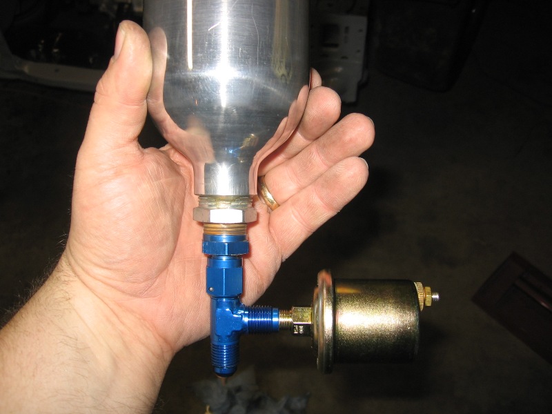

EDIT - Here's a few pics:
The bottom of the accusump fas an AN tee fitting. I tapped the 3rd leg of the tee out for the oil pressure sender. A braided line goes from the original sender location to the bottom leg of the tee

What is the diameter of the pipe to the accusump? I have one in the Porsche and my line from the accusump to the motor is 1/2 inch I'd. From the photos the lines look really small. This could be hindering the filling if the accusump with rapid increases in rpm. This would cause the oil no to fill fast enough in to the accusump. With a new motor I amuse the oil pressure is really good and responds very rapidly to changes in rpm. My car does not have a valve I run two quarts over full. Another reason to run a pre charge on the accusump is to force the oil through the motor in start up. With out it oil is filling the a ccusump.first then going to the motor. This causes extended period of time St start up that the bearings are running dry or with very low oil pressure.

What you have in the picture is not an Accusump. The Accusump has a divider piston and a charging space and does need a valve to function correctly. What you have there is a Moroso (or similar) open accumulator. It does not have a valve and is not pressurized prior to use. It does not provide pre-oiling like an Accusump unless you add a solenoid valve, as recommended. It's designed to provide reserve pressure for fluctuations while running. The shrader valve on top is for purging it when changing oil.

djsilver wrote: What you have in the picture is not an Accusump.
Good call I did not even notice. I was fixated on the plumbing of the unit.
