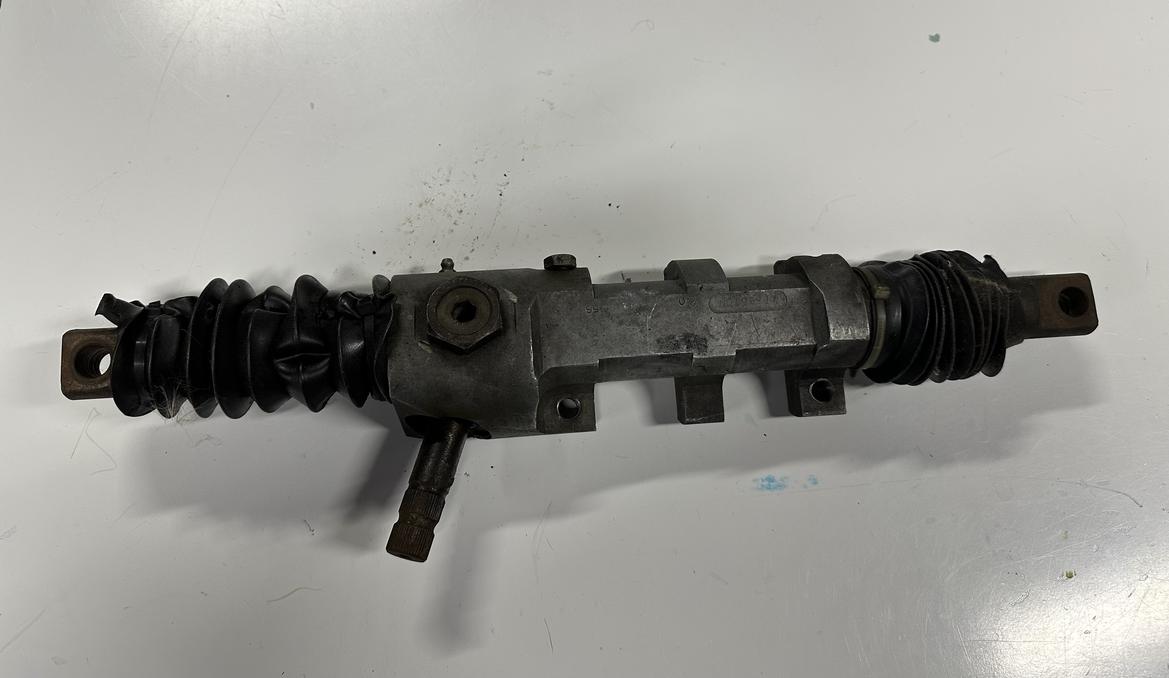

Is this what you need for steering?
nocones
nocones PowerDork
4/5/25 3:45 p.m.
In reply to DrMikeCSI :
Probably something like that.  I'm going to look at Honda center steer racks, or if I can just use one end of a normal rack and have a nice bracket.   There are many center steer kart type racks for cheap on the jungle site..  but I'm not sure those are better then a backyard modified OEM rack would be.    I also may look at a VW beetle steering gear like what is used on Formula Vees
