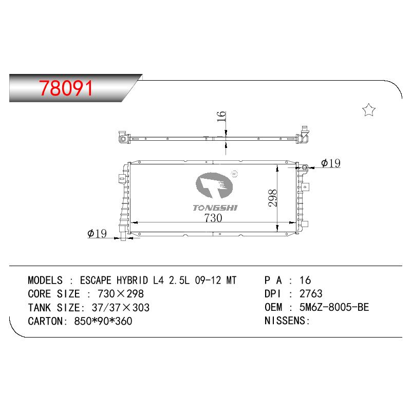

this might not be a priority, but I reckon the radiator isn't going to help with the "manx-ification"... and also, you probably don't need a full-size miata radiator for challenge.
taking a quick look at Summit's selection, brings up the 05-10 Ford Escape Electrical system cooler:
https://www.summitracing.com/parts/tyc-2763
which has these dimensions:
i.e. 28in wide by 12in tall
dunno how'd that fit in the current front end and/or coolant tube deals?

playing with radiator is the kinda next priority.  After I get all the crap out of the car.  I for some reason am convinced I need to "keep the AC system intact" because..  I'm not sure why.  I want to have a heater as there is a small chance I will do some limited street driving with this.  But...   I am convinced I "might want to use this chassis later for something" so I for some reason want to keep AC alive..  but that's just ludicrous.  If  I pull all the AC stuff, and get rid of or relocate the power steering cooler the radiator may move quite a bit in the front, or it can go to the back.  But a smaller radiator is not a bad option also.
