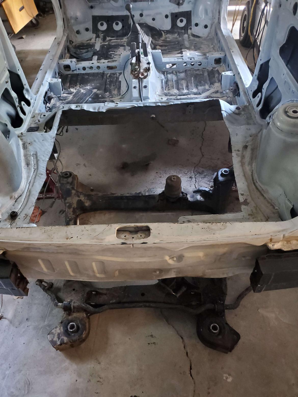

The next step was trying to mount everything into the rear. After a considerable amount of research and a couple junkyard trips, we landed on a toyota camry subframe and suspension. In the junkyard, we decided it was a good idea to get some measurements so we could try to replicate this geometry in the Festiva.
Unfortunately, we went a bit overboard
This is where we’re at now, more coming soon!

Over the winter break, we worked hard to get the car on the ground. In the rear of the car, we have the Camry subframe mounted with a set of cross bars. Temporarily, we used the front Festiva struts with cut springs and fabricated tabs to adapt the Festiva shock towers to the camry knuckles. As of now, the bolt pattern forces us to use the beautiful Mazda wheels, but Porsche wheels are coming soon.
Toyota Camry Subframe and Suspension
Custom Tabs To Bolt to Camry Knuckles

When we put the motor in the car, it technically fit. However, the axles were blocked by the frame rail on each side. Additionally, the motor mounts also interfered. We explored our options and decided on the coolest option : Tube Frame. We chose to do this because of our immense experience building tube frames. (precisely zero)
First we cut out everything from the rear. Then, we cut more out. Then more.
First we made some hoops
Then we got the tubes in place
Engine is in
