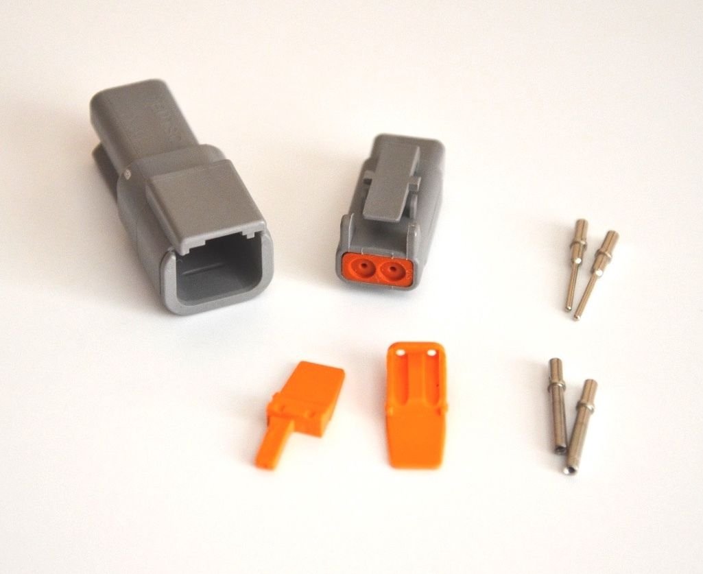

Tail lights were high on the "legality list" and were pretty straightforward. Karl had left a nice pigtail of 4 wires at the rear of the bed which needed to be terminated in connectors, wrapped with heat shrink, and routed. Dan and I confirmed pinout and Mikko did the dirty work of wiring it all up. He used DTM connectors at each light housing and Raychem DR-25 along the whole length (it would've been rude not to)...
Wiring pinout was as follows:
  • Purple: R brake + turn signal
  • Yellow: L brake + turn signal
  • Brown 1: tail lights
  • Brown 2: license plate light
  • Ground: through the bed itself
We found the original license plate mount & light from the factory were still hiding under the rear edge of the bed and had never been used, since the truck had one of those monstrous dealer-installed diamond plate step bumpers. Mikko cleaned up the housing and glass, replaced all the bulbs, and viola. The soft glow of the '60s was back.
