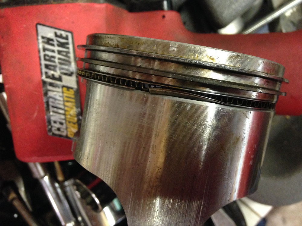

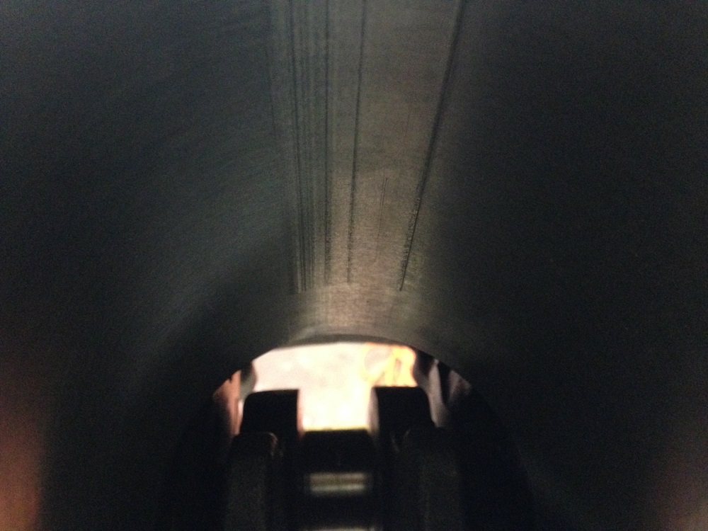

Ah ha! this is the culprit. The oil ring was kinked during the original install. It is fortunate I pulled the head, because of my gasket concerns, and found it. While this is not great, it is useable rather than the total destruction that would have happened if I didn't catch it.
This is a ball hone. Some people call it a dingleberry hone. It has an abrasive in the little balls that is held under a light spring tension as you spin it in the cylinders. These will not "fix" a cylinder, but they are good for deglazing, or knocking off a light rust coat.
Even after the ball hone-ing you can still see the scratches.
I've also been wanting to fix my dipstick tube while I had everything off. But these fixes are a slippery slope.. the "Might as wells" Might as well re-do the exhaust while everything is out of the way. Might as well paint the engine compartment. Might as well make a new turbo manifold if I'm doing the exhaust. Might as well put some coil-overs on the front while everything is apart. etc...

Glad to see you're back at it. What are you going to do about the scratches? Leave em?

Heh. Welcome to full restoration land. Mine was fix the floorpans. Turned into frame off.
So what DO you do about the scratches? My 350 had similar in a couple of bores when I changed the head gasket. I said Berkley it and put it back together. Now im wondering.

The correct answer is bore it oversized and use new pistons/rings etc. It will loose a bit of oil. But, I'm going to run it 'til it blows up and then build up the better/more powerful DOHC motor.

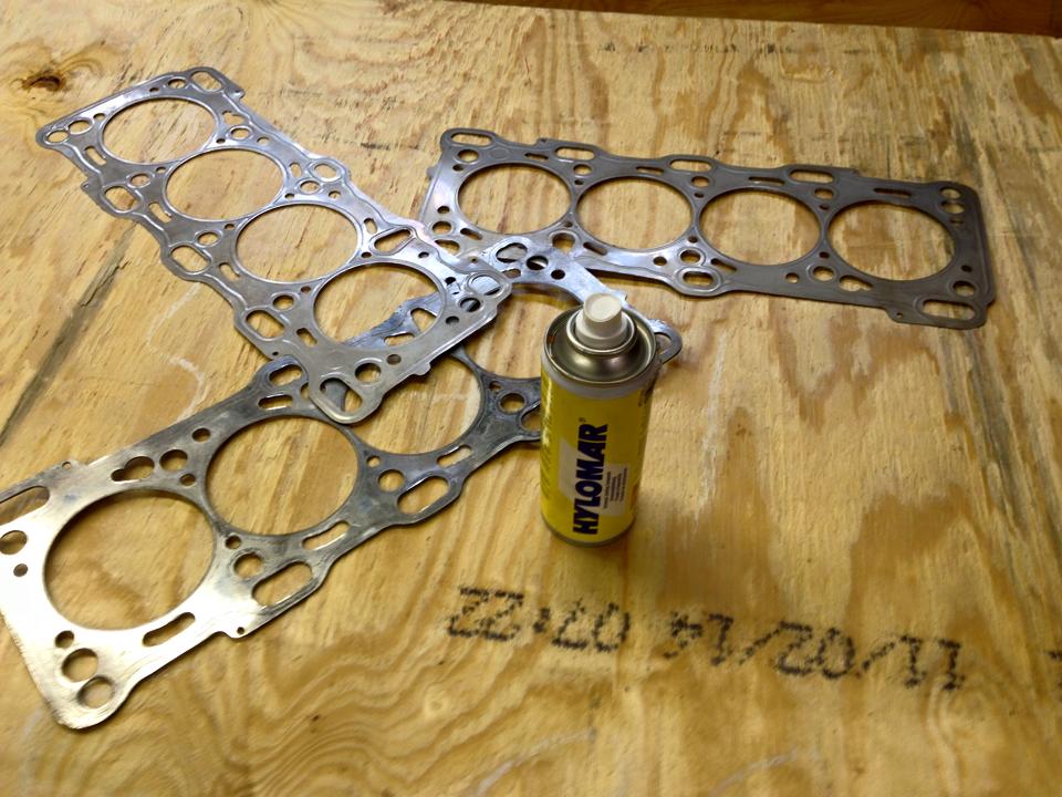

I'm testing using hylomar on mls head gaskets. It seemed to go well. I coated both sides and let it sit for 10 mins per instructions. It is gummy feeling stuff. They say it never really dries which is supposed to help the seal. Before I sprayed it on the block I put some paper towels in the cylinders. Whatever excess I got cleaned up easily with brake cleaner.
The engine is a pain as always to get on the motor mounts. Once I got it in, it ran like crap. It was lean. Way lean. Like beyond the reading on my wide band lean. Turns out it was the map sensor. If you look closely to the left in the above picture, you'll see the map sensor on the too short vaccum line. That green wire was pulled out just a bit and caused my problem.

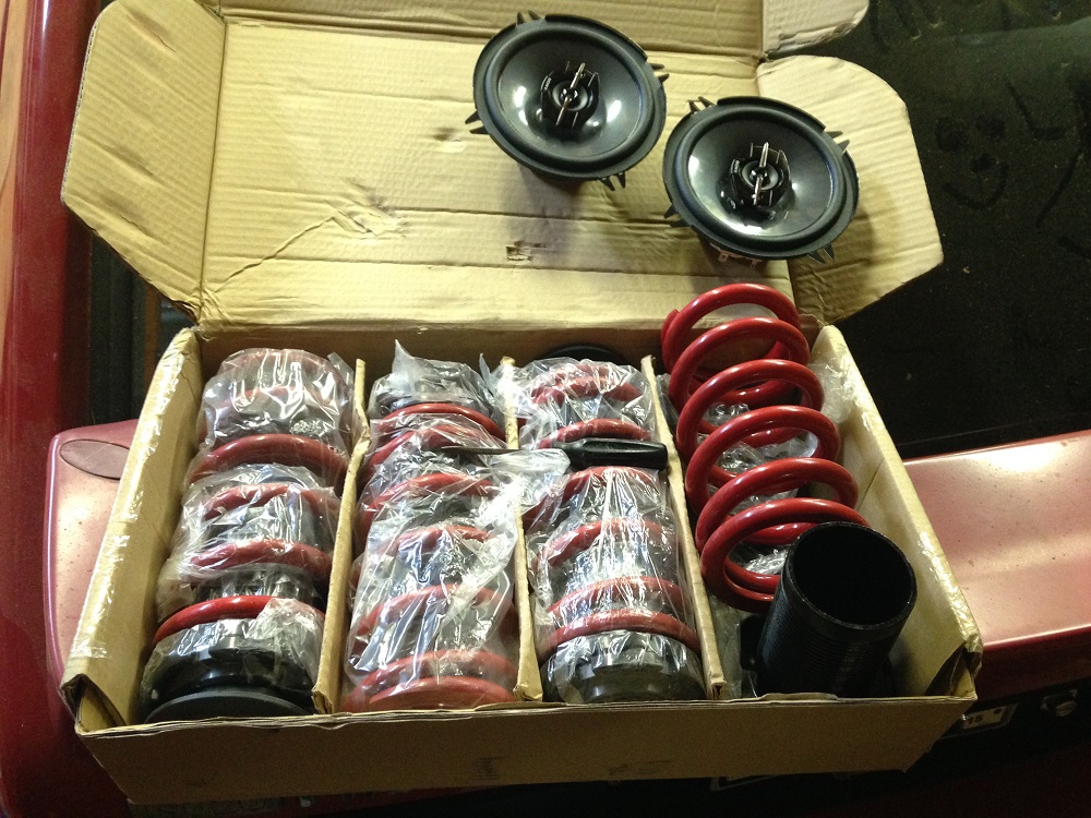

With the CV axels out I "Might as well" put some coil overs on, oh and camber plates.
Unfortunately those were too small and I had to re-order a larger pair. The nice thing is that they are not pre-drilled, and I can make them fit my application.

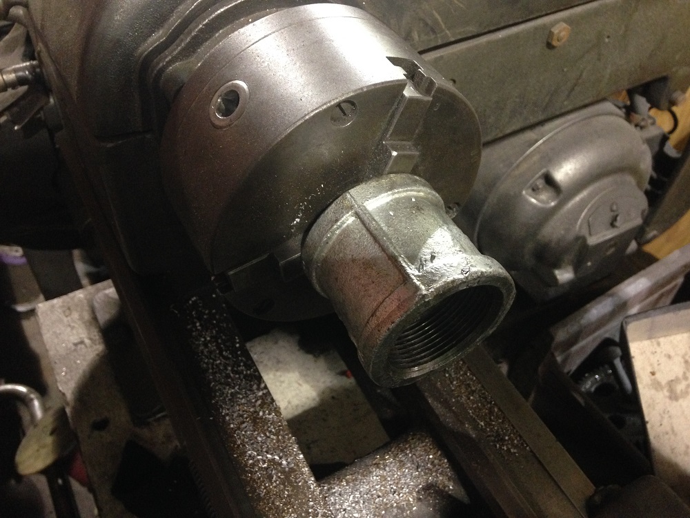

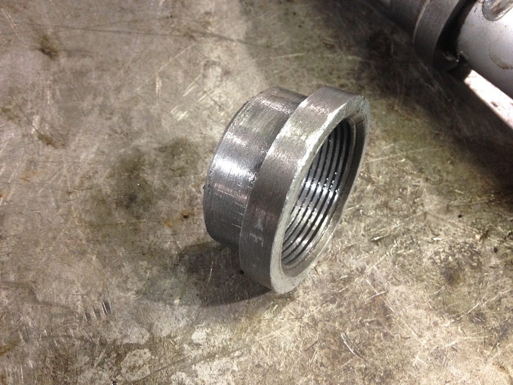

The ebay coilover kit is not intended to work with camber plates. I did not know this. Turns out you have to have a special spring perch with an integrated bearing, as well as a special spacer to keep the perch off the bottom of the camber plate. The bearing allows the assembly to turn when you turn the wheels while the camber plate of course does not move. So I threw away the rubbery spring perches that came with the kit and ordered a set of radial bearing perches by fortune auto through stmTuned.com
Unfortunately their inside diameter was wrong. I needed 18mm. Nothing a little ride in the lathe wouldn't fix.
Note how the camber nipple keeps the perch from bumping into the camber plate.

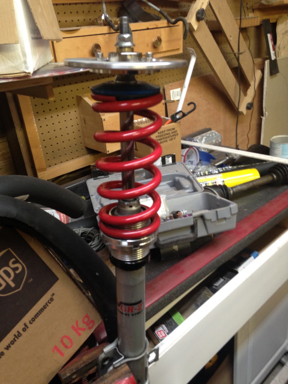

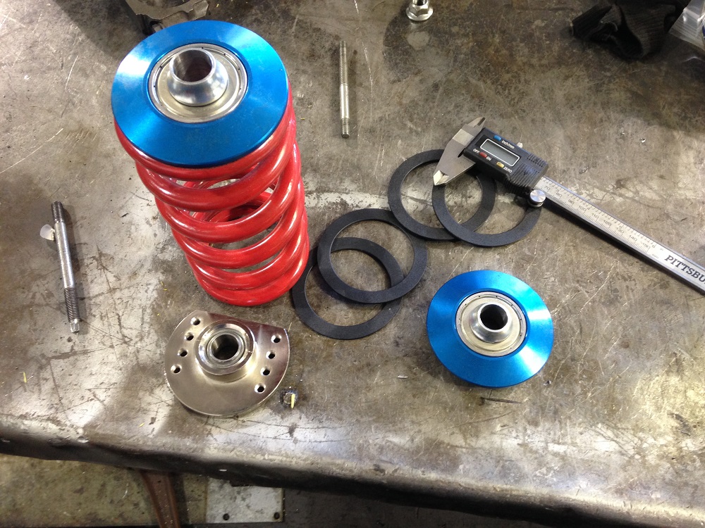

If you were following along at home and wanted something similar this is the break down
  1. Ebay coilover kit from a Honda
  2. Strut nut - comes with the strut
  3. Fortune Auto spring perch with bearing
  4. Custom made lower spring perch
  5. Spacer included in ebay kit.
  6. Sleeve cut down for height
  7. Spring washers included in Fortune Auto kit
  8. Camber plate. Universal one - drill your own holes
  9. Assorted rubber O-rings (you should get really pissed if these aren't included in your coil-over kit)
  10. Everybody says coil-overs will kill my struts. So I may be upgrading soon. (I was not impressed by how easy it was to compress them)
I selected the approximate size o-ring and stuffed it in with a screw driver. This was mandatory so the sleeve wouldn't be floppy at the top. Keeps crap out too.
You can see on the left side where I tack welded the sleeve in place. I don't recommend a lot of welding because the contents are under pressure and may explode. I welded a very small amount and quickly cooled it with water.

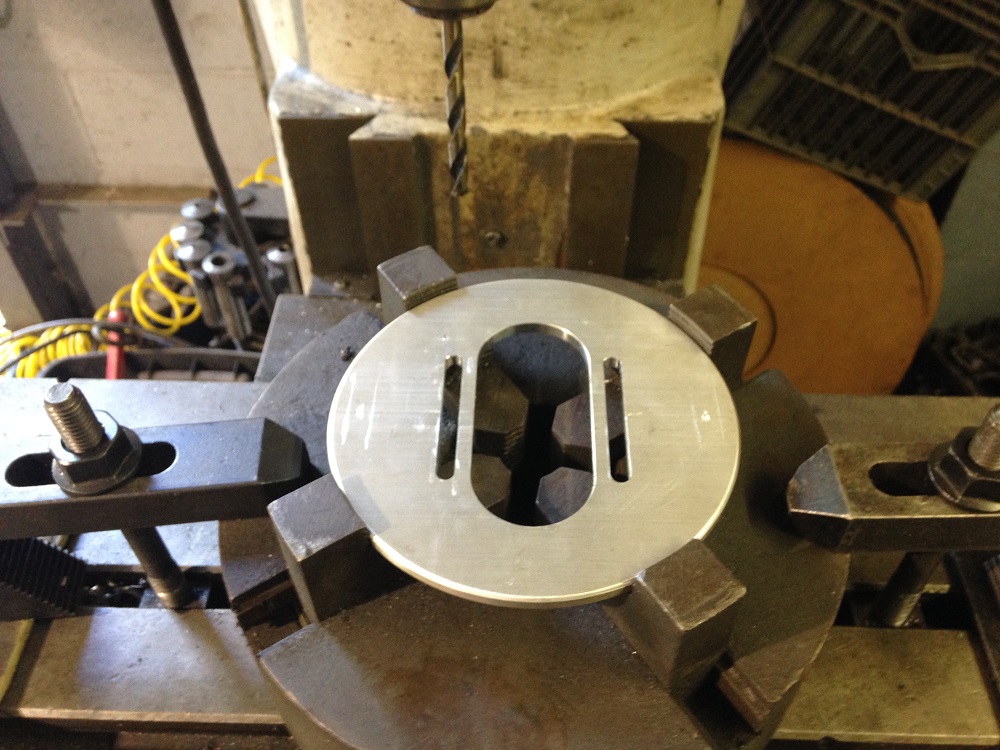

Drilling the camber plate.
I tapped it for an 10mm stud, and then decided to use a bolt instead. I wanted the extra bit of support from the flange on the bolt head.
Final assembly:
I put a bit of paint at the bottom to keep the thing from rusting. I have never done this before, so please chime in if I did something wrong before I put this on the car.

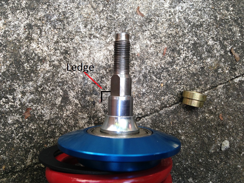

upon further inspection I may have made a mistake. I need to rest the plate on the "ledge" of the strut. Right now if I hit a bump there is nothing stopping the strut from shooting through the hood. I'll update the main post when I sort it out.

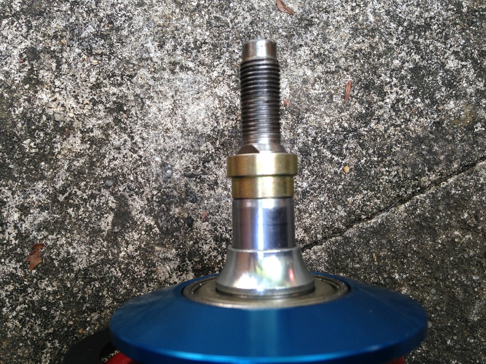

OK. My mistake. You'll need 2 sleeve/washer/spacers. Possibly 2 different sizes for your specific strut.
The ledge captures the camber plate. (and keeps your struts from shooting through the hood)
This is the original orientation of my spacer. I flipped it over so the camber plate would rest on it and it on the ledge. I may have messed up by drilling my blue perch oversize to match my strut shaft, but I can't foresee any negative outcome from this layout.
The fix was to use a spacer below the camber plate to rest on the ledge and another smaller spacer (not pictured) to rest on top of the camber plate and receive the nut.
Other designs use a long spacer-nut combo, that allows it to thread and still achieve the stack height.
Anybody picture a problem I might have by allowing my blue perch to float un attached to the camber plate?
