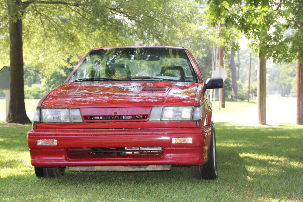

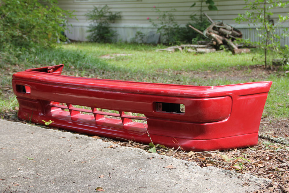

I got another coat of paint on the bumper, sanded and polished. It still isn't right, but it will have to do until I paint the whole car. I couldn't get all of the peel out without sanding too much off. Since I was out of paint, I let it ride. Still way better than before
I think it looks pretty mean with no bumper

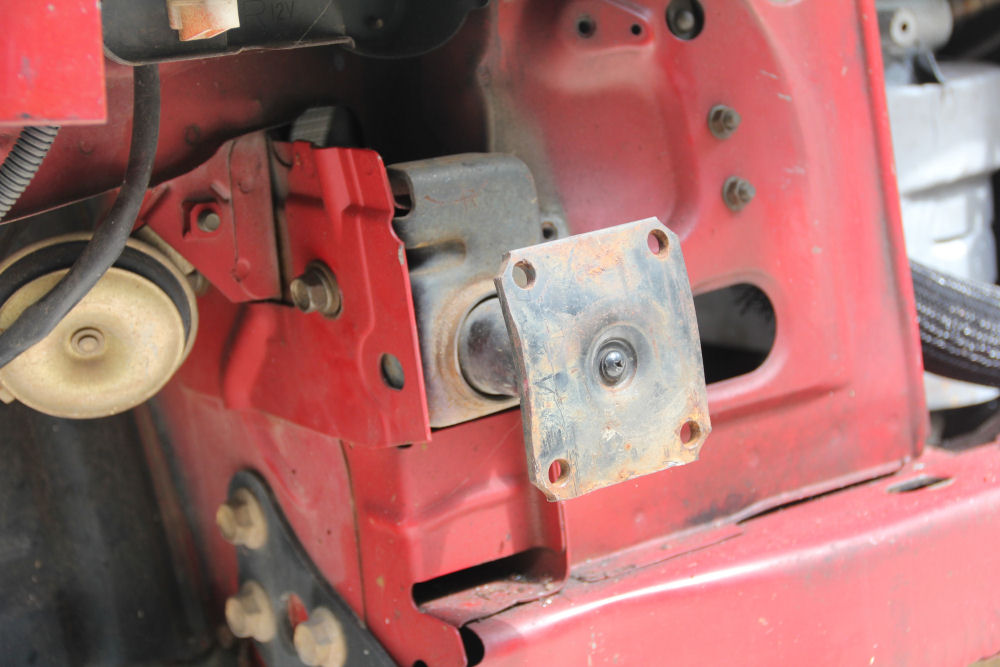

The bumper shock mount was bent from an accident (previous owner) I couldn't get the bumper to line up. It was always low on the passenger side. So I took the mount out and elongated the holes for adjustment.
My daughter gave me a hand with this part.
Right about then the dogs in the back yard started going nuts. When I went back there to see what was up I found this:
That was a copper head. See the gold on his puffy cheeks. (Puffy cheeks mean venomous. That is where the venom sacks are) He was a juvenile. The picture makes him look bigger than what he was.

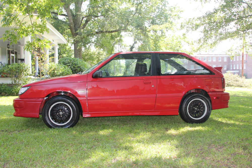

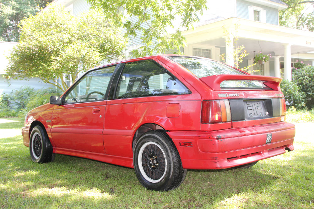

All finished.

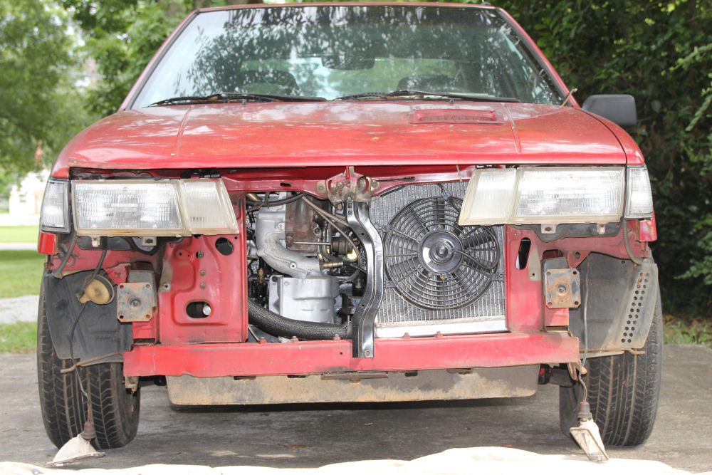

I freakin love my clear corner and bumper lights. I'd even keep these rims if they were 15" and actually round.
I still need to install a metal deflector next to the radiator so the air will go through rather than around it. Then I'll work on the gauge pod.

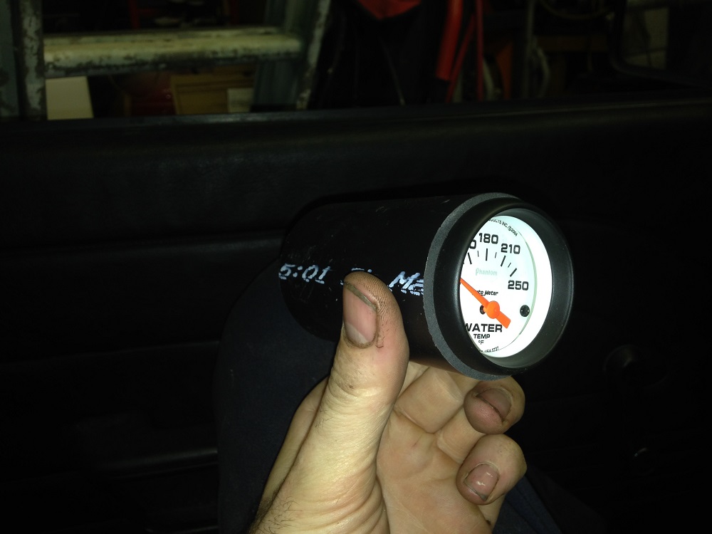

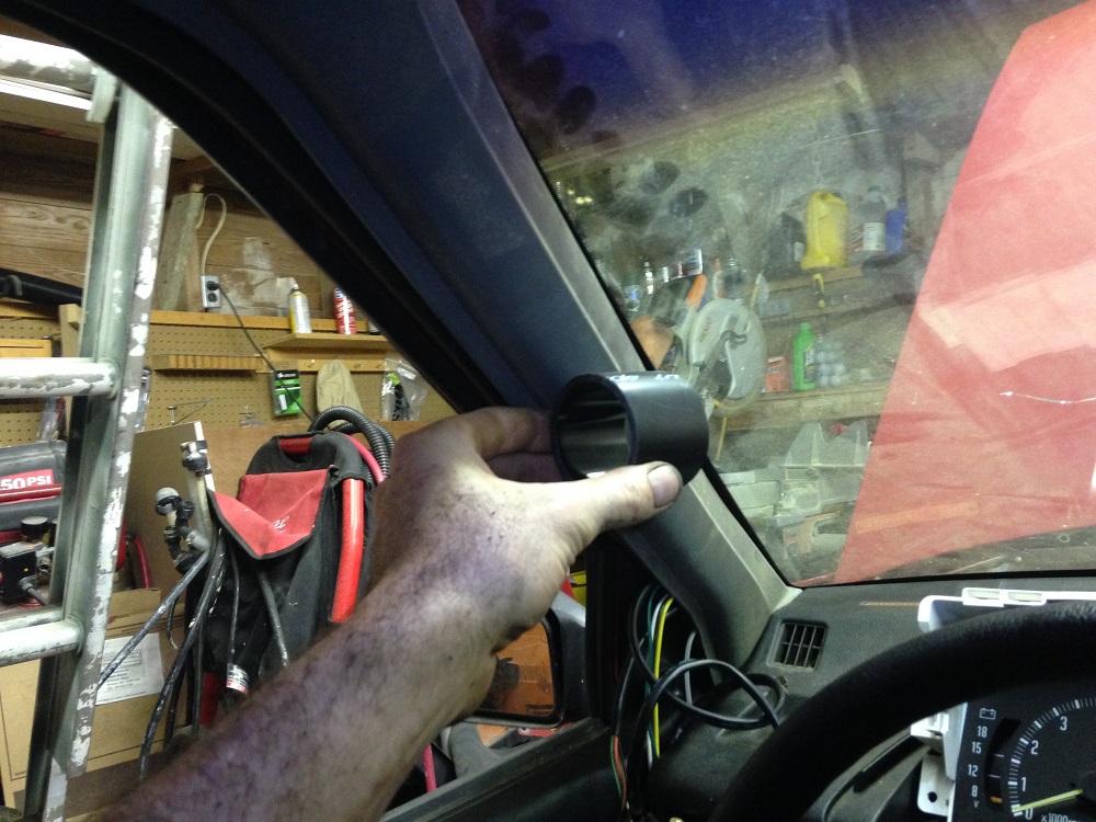

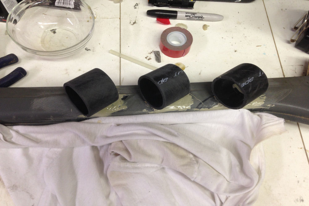

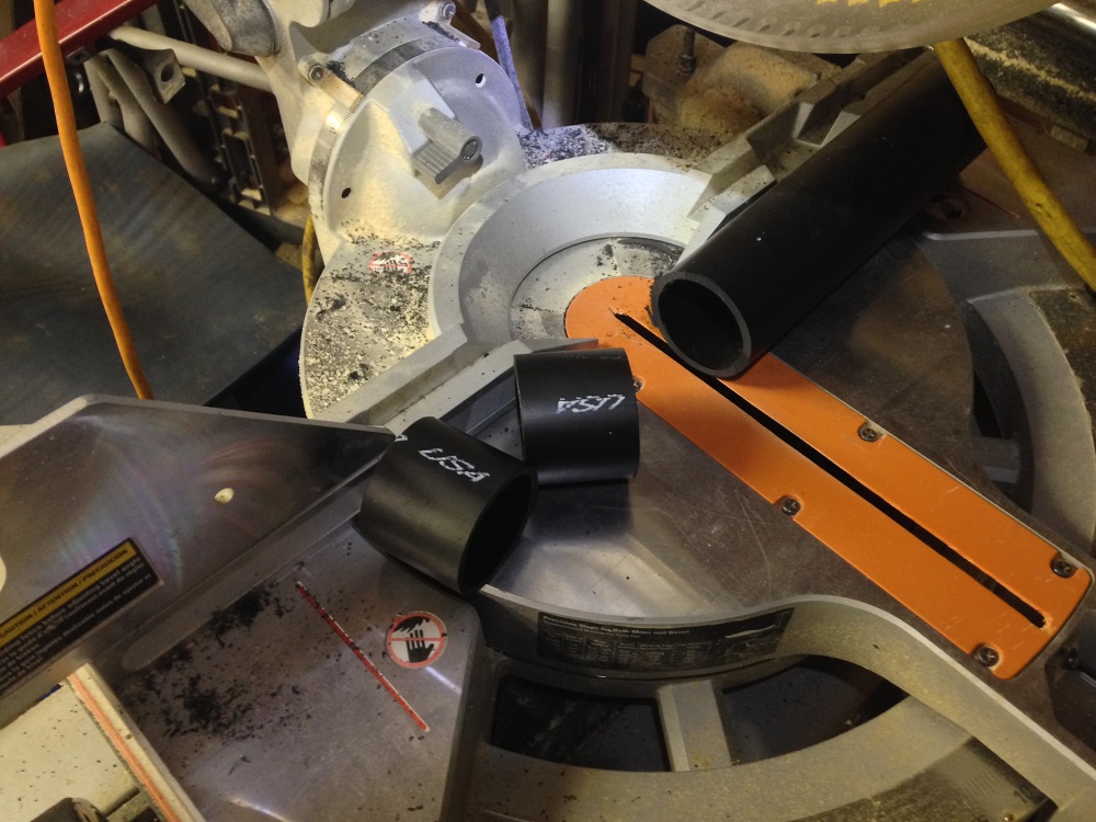

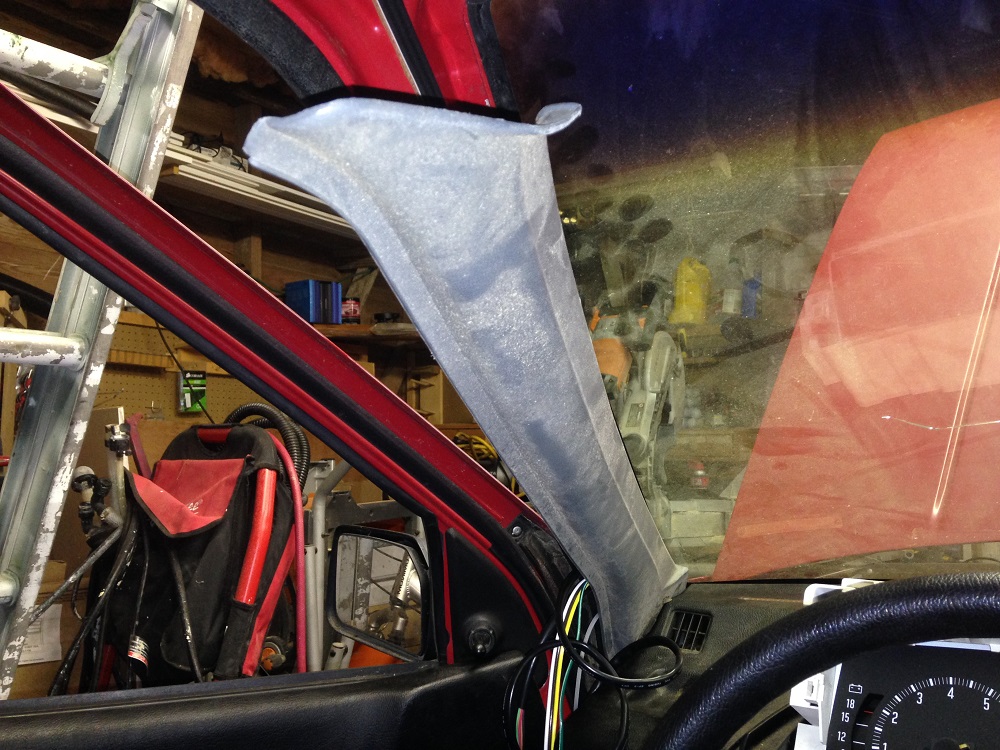

At the beginning of this build I mentioned making a gauge pod, and I'm finally working on it. I don't have room in the radio console to mount my gauges, and I don't want to mess up my dash by attaching them there. So, the 'A' pillar made the most sense.
I bought a junkyard piece of pillar trim so I didn't ruin my original if it didn't turn out.
The gauge fit perfectly in a 2" pvc pipe.
So I cut some more on the miter saw
Test fitting for the proper angle.
I hot glued them in place so that they could be adjusted. I think the angle is perfect, but I had to work on the spacing.

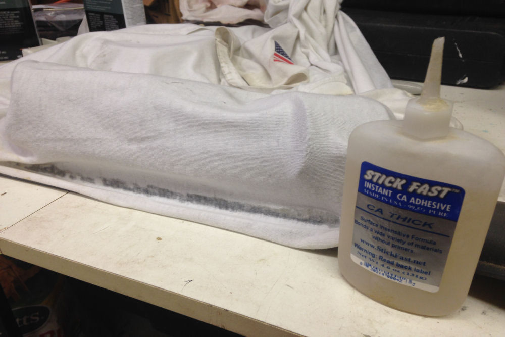

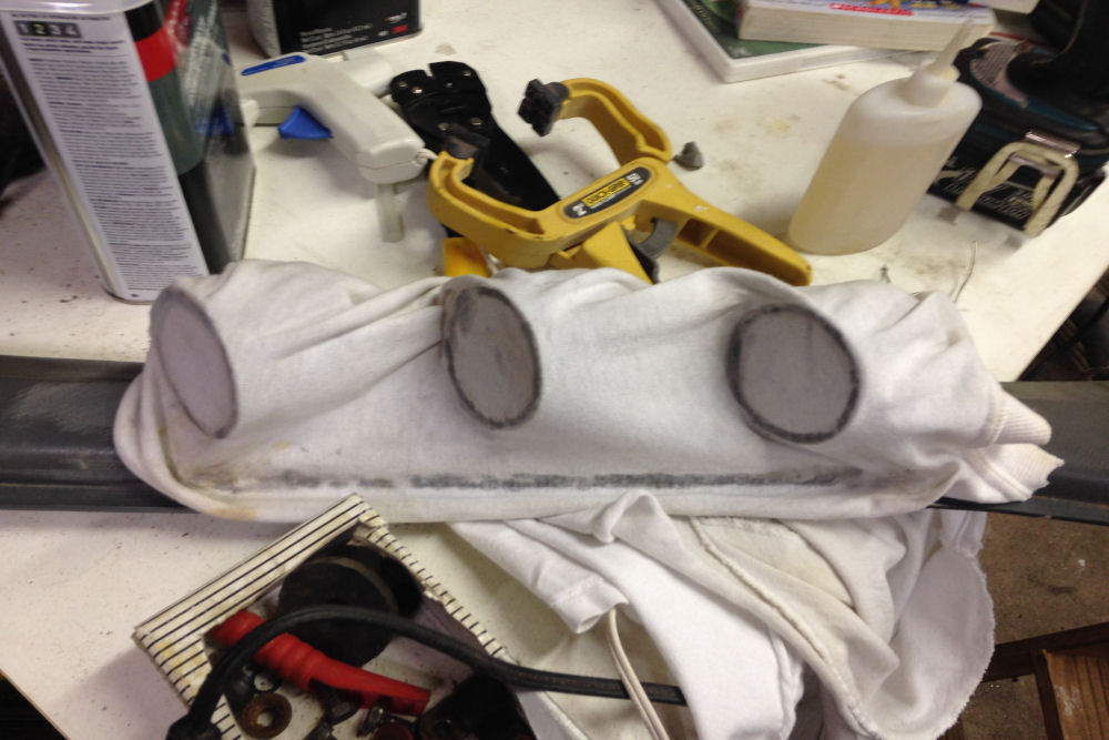

I researched on line how to do this. People use lots of different methods. The best examples of how to do fiberglass were the guys making tweeter pods. I also saw that lots of people had problems with their fiberglass popping off over time from the heat. I hope to alleviate that buy using the left over flexible bumper filler I used earlier.
I added a bit of wood under the front to give a bit more of an angle towards the driving position.
I couldn't clamp the shirt in place so I used super glue to hold it while I formed it around the pods.
A bit of glue to the ring to hold it while I get the wrinkles out.
And the rings are done
If I ever do this again (or scrap this and start over), I'll wrap each pod individually in t-shirt. It is too difficult to smooth all the wrinkles out with 3 lumps in the middle.
Next I'll attempt to smooth the wrinkles out of the back side and then apply the resin. I think I may cut and tuck some of the excess off the back side. We'll see.

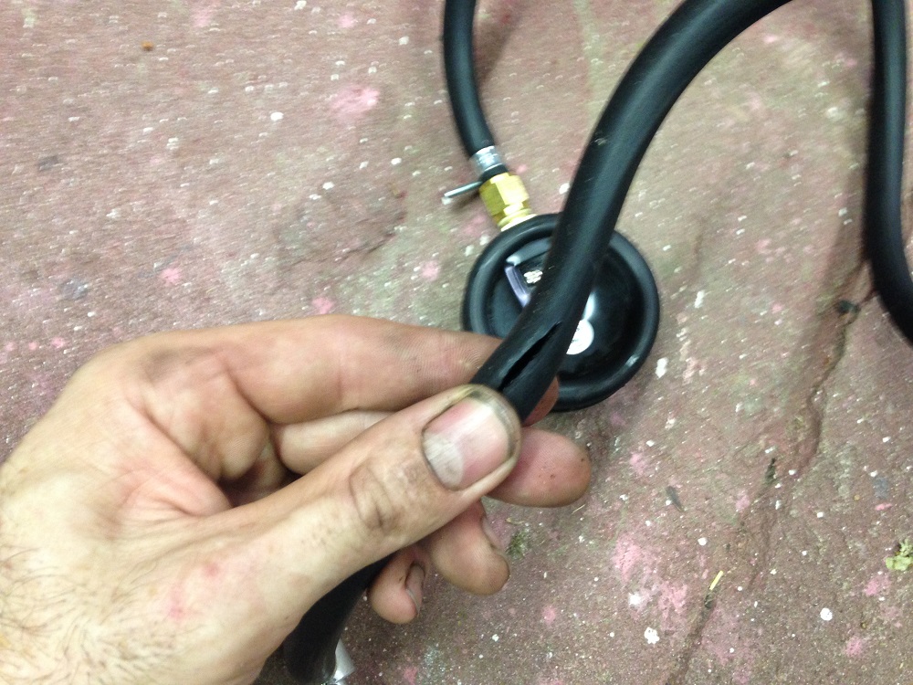

I was doing some test runs, and had a serious bogging issue. Parked in the drive way the car rev-ed fine. No bogging, stumbling, or any hick-ups. But once I was on the street and accelerated it hit a wall at 3k RPMs. The AFR gauge said it was leaned out as much as the gauge would read. Then it would sputter and pop and then come back to life violently for about 1k RPMs before it would bog again.
So, I bought a fuel pressure gauge to try and figure out what was going on. $20 from Harbor Freight.
I used the T fitting in line before the fuel rail. I was not so lucky to have a simple fitting I could screw into.
I had to make a quick trip to the parts store for a piece of fuel line hose. I snaked it under the hood next to the wipers, and placed on the wind shield facing in. That way I could read it while driving to understand what was going on. Off I went on another test drive. I pressed down hard on the accelerator and while it was bogging there was no change in the fuel pressure. So, I eliminated the fuel pump and FPR as possible problems.

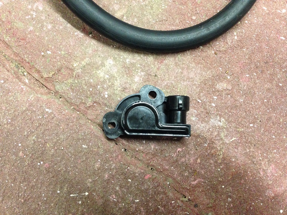

The only component left that could regulate fuel was the throttle positioning sensor. I whipped out my multi meter and was looking for 5volts. I had 5 volts. I had 5volts at every pin. BAD. $23 later after a second trip to the autoparts store I had my new TPS.
After plugging it up my idle instantly became better, I took it for a drive and what a difference! It still wasn't boosting like it should, but I was actually driving. After 4 years of working on it, It felt great. Yes, the interior was squeaky, and the alignment was so bad the wheels would sometimes squeal going forward, but I was going forward!
I let the car cool and went back outside to remove the gauge. When I got there I smelled gas. The line the parts store sold me was NOT a gas line, it was swollen and floppy and had burst open, spewing fuel over the engine bay, I'm lucky it didn't burst earlier when the car was hot or there would have been a fire.
What really annoys me is that the I initially asked for fuel line and even asked a second time when I checked out to confirm it was fuel line and there were like "ummm uh huh fuel line."
I took it for a few shake down drives. Once I found and repaired the boost leak, I discovered that the car was over boosting. It was Oh My God! from 3k to 4k RPMs then fuel cut hit and the party was over. I adjusted my boost controller but it seemed to have no effect. Until I discovered I turned it all the way in the wrong direction. So I was turning it all the way up rather than all the way down.
Still, OMG fun
Second issue is a high idle. Unfortunately the Storm SOHC TPS sensor has a different voltage than the I-Mark. So, I'll have to do some research to see if I can just twist the sensor to turn it down, or if I have to come up with some sort of electronic circuitry to lessen the voltage.
Third issue is overheating. I currently have a push fan. Perhaps I need to swap it around to the other side to become a pull fan. Although I remember talk of the excellent cooling from these half radiators, and how they never really got hot.... hmmm....
Still, OMG fun

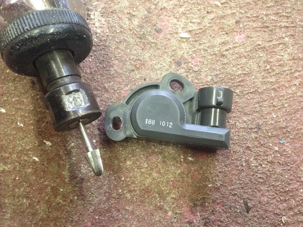

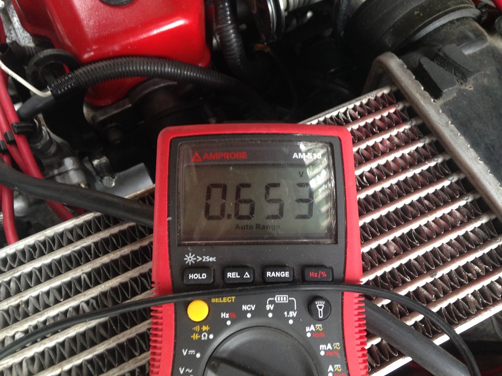

I thought for sure my new TPS would solve my high idle issue. The thing will almost rev up to 2K RPMs just sitting in neutral in the driveway. I've been worried about the difference between the voltage on the I-Mark VS the storm TPS. Using my trusty multimeter I pulled back the wire cover and tested to see where I was at. As I expected my voltage was higher than the .4 volts the Manual said I should have at idle.
So, I enlarged the holes on the TPS to create a slot rather than a hole to adjust it.
The slot worked perfectly, and I was able to get the voltage down to .4 volts, while still achieving the 4.3 at WOT.
Unfortunately it made no difference whatsoever in my idle.
Next up is testing my IAC
