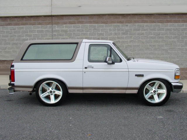

hobiercr
hobiercr Dork
11/26/13 3:37 p.m.
Don't go crazy now.
hobiercr
hobiercr Dork
11/26/13 3:39 p.m.
tripp
tripp New Reader
11/26/13 4:55 p.m.
Haha excellent. My girlfriend and her friends will be the final call on style etc so I think they will keep the bodywork in check. But I was thinking a slant nosed bronco....
tripp
tripp New Reader
11/26/13 4:56 p.m.
Not doing 22s like the pics that's for sure
