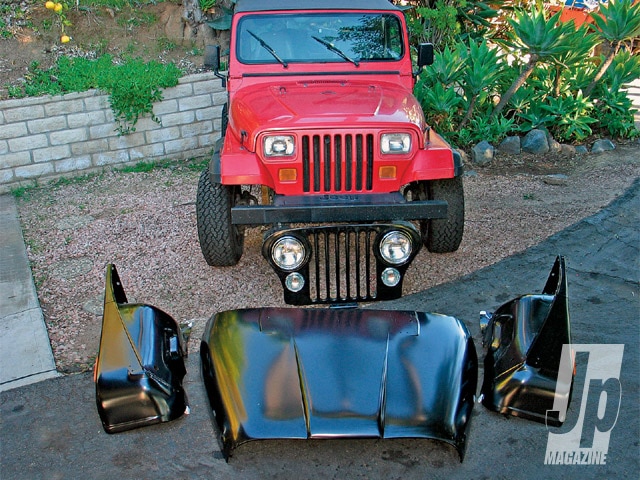

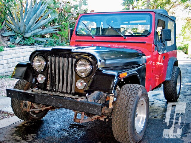

Thanks Woody.  Now that I have the  YJ though, the square headlamps are like a badge of honor or something.
Maybe Huey Lewis was onto something..."It's Hip to be Square"
I still prefer the iconic round headlights of a true GP "Jeep" but I got a square one...might as well own it ;)
