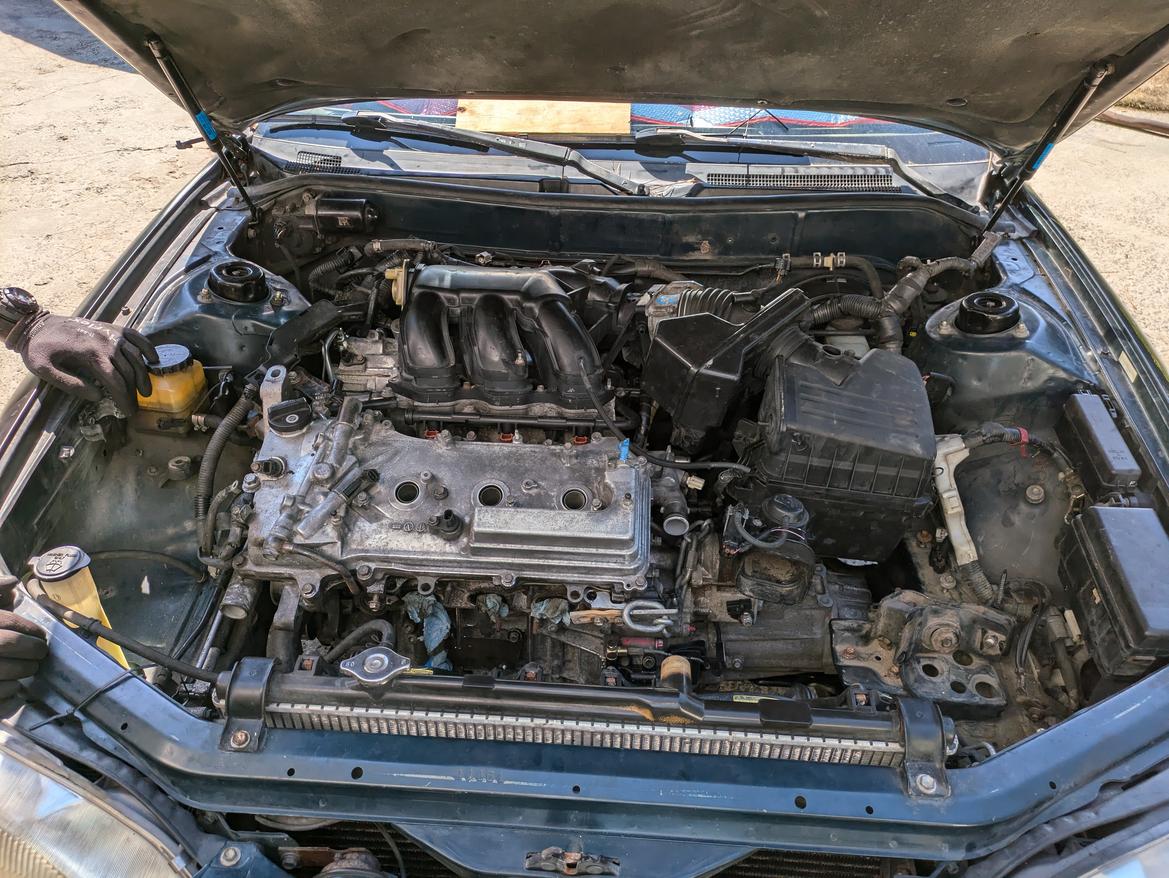

Fits!
The hood shuts too! Got all the info I need to design motor mounts.
