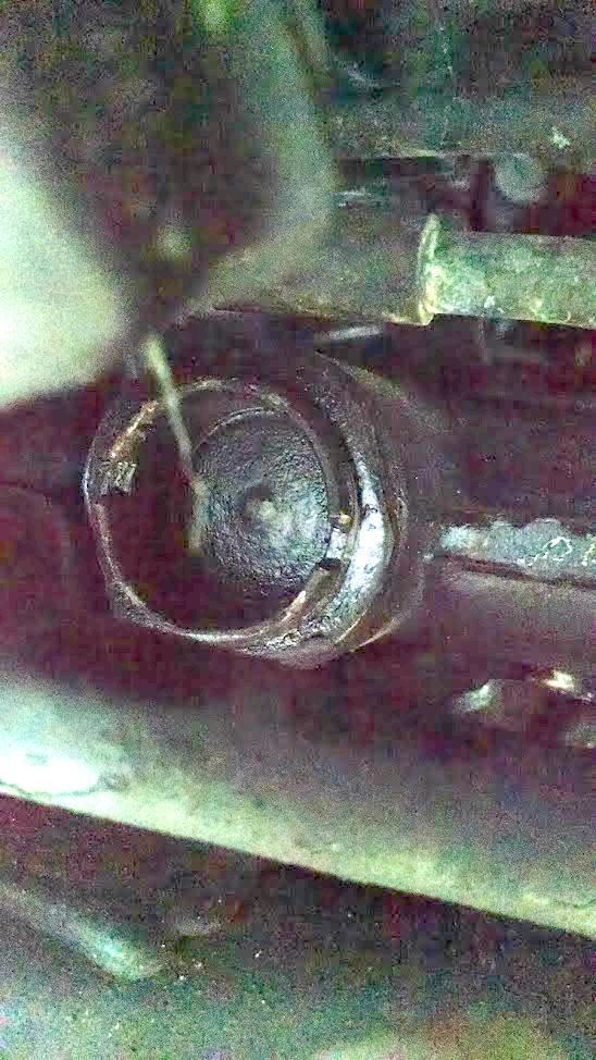

With the Challenge approaching next week, and therefore a 700 mile road trip, I addressed an issue that's been bothering me. The steering has always felt loose, which is noticeable especially on the highway and while accelerating hard it tries to steer all over the place.
Through a series of tactful yoinking of the front wheels, I had narrowed it down to inner tie rods. But once I pulled the boots off, it was actually the rack moving around within its housing. And quite a bit... probably 1/8" of radial play. This was disappointing because I bought tie rods, not a whole new rack. But I found out you can adjust the tightness of the rack by squeezing your hand and a pair of large thin pliers between the firewall and sway bar to loosen a jam nut, then use a flat head to chisel this tubular thingy an 1/8 rotation or so inward.
The slop is pretty much eliminated and it drives better than ever now! Inspires much more confidence on the highway to keep its own lane. Looking forward to the Challenge.
