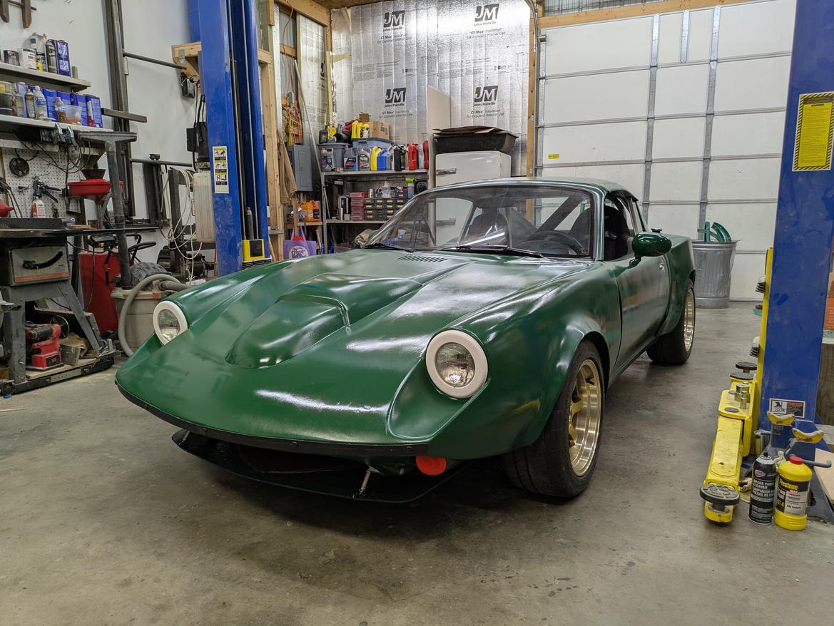

Coming out of the paint "booth", I'm very pleased with how the silver and green combo work together. I only picked the silver because it was on the shelf already.
Body sections, looking pretty uneven especially on level of shine, but I never claimed to be an expert.
And the rear "glass" now installed into the hatch cover, weather stripping glue is looking ugly but I have a plan to clean it up.
Finally, finally, finally all together!
just one more part missing. Now if you were to say that the nose of the car resembles a certain someone, maybe a certain muppet, who would it be?
Green paint + white "eyes" + red "tongue" = Yup! It's Ker-miata the Saab!
