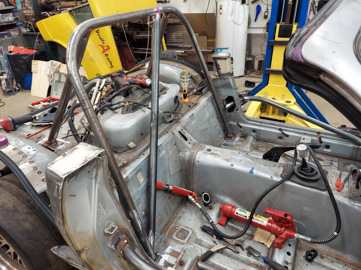

More fiberglass work to do this weekend but over the last few days, something different is taking shape.
First a 'template' made from scrap plywood and some brake line.
Then it's time to break out the affordable bender which is... affordable.
 I guess I can't complain about it too much but it only works in the upright position and it's easy to make your bends in the wrong place.
I got the first 2 right though!
It was only after I made the main hoop that I realized I wanted it all the way out to the corners though, and these were in the way...
So I got rid of them. obviously, the gussets will be added back later when the bar is done.
I made some feet for the bar and stretched the legs back open by 2 inches.
This was a whole process where I trapped the bar under the lift with a car on it, but I didn't take any pictures of that.
But I did have to make a little squaring set up to make sure both sides were even.
Other than that, I made the rear bars and support plates that sit nice and close to the rear struts.
The plan for now it to build a half cage, (just this, harness bar and door bars) and try to add a lot of the rigidity back into the frame since, you know, half of the car is gone.
Do ya'll think it would be worth it to add a small brace from strut to strut (with one inch tube) to add more stiffness or will the cage be doing that already?

A diagonal in the main hoop from driver's head to passenger floor would help both for rigidity and roll-over protection, I would think...

Oh, yeah, left that out of the post but diagonal will be included with the harness bar intercepting it.

5/5/23 2:48 p.m.
Well, after finishing up the door bars, I pulled the cage out and finished all of the welds that were just tacked before. I was running low on argon and attempted to use it all up but didn't actually run out. I was headed that way so I went and got the bottle filled on my way to work anyway.
Next, I dropped it back in the tub and made sure all of the corners were sitting in the right places and made up a cross-bar.
You can see I'm using a lot of over-kill to hold it in place while I tack the corners.
After I got that all welded up too, I went back to the door-bars.
This is the bracket I had made up already, I mostly wanted to get an attachment point on the outside of the car body somehow. Since the footwell brace is essentially on the wrong side considering that all the forces will be coming from outside the car, trying to make their way inside the car in crash. (And if they're not, I've got bigger problems)
After looking at this for a while, I decided that there was not enough weld area on the bar itself and added 2 more gussets.
One under the bar and one on top.
And here we are, Lastly I need to make the harness bar before crossing fingers and welding everything down into the car.

Well I got the harness bar tacked together on Saturday in a process that took way too long. I must have checked-modified-rechecked that bar 50 times or more but I finally got a good fit.
I also finished the passenger side on Sunday and took zero pictures.
But with that all done, I decided it was time to actually attach the bar to the car so I cleaned up all the paint and dirt off the miata body, took a deep breath, and then put the fiberglass body back over it for one final test fit.
And, I already knew that there was a small gap between the bar and the roof but after looking at it again, and seeing how little clearance we would get for our heads, I decided to bump the bar up 3/4"
And how to do that without starting over? Little boxes.
I did end up changing this shape a little bit, but it's just a box made from 1/8" metal that I will weld down to the floor/ rocker walls and then weld the bar down on top of. With these installed, the bar is super close to hitting the roofline for maximum helmet clearance.

Kind of a slow week but I got the cage finished up. Here it is on top of the spacers.
Which are now fully welded, mediocrity abounds, boys!
I added some plates back in where the original gussets were removed.
And then added in the door bars, their brackets and some extra attachment points.
The only issue was, there was no way to weld the back of the doorbars where they meet the cage, so...
And more mediocre welding to finish the job.
Safety! I guess.
