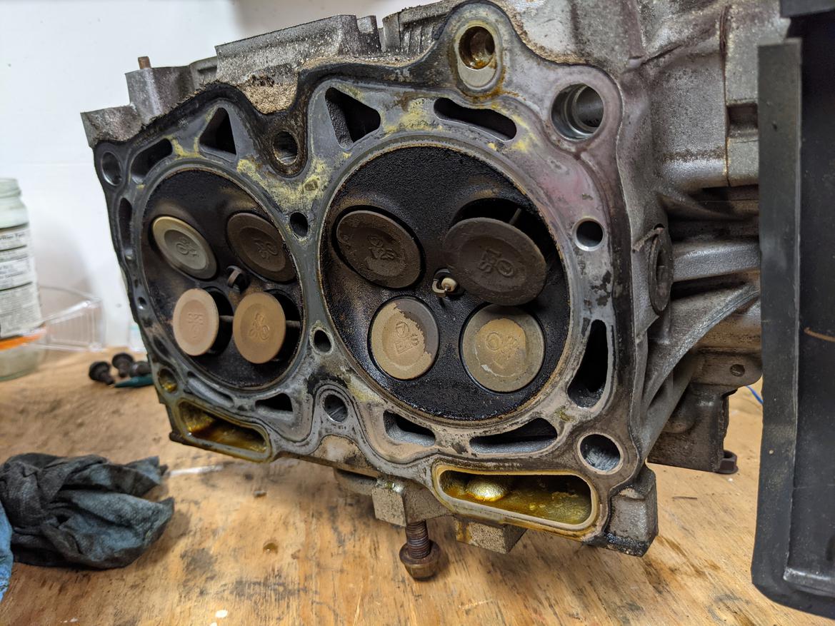

9/9/21 12:40 a.m.
Got the heads off!
To be honest, I have no idea what I'm looking at here. If anyone knows of a good machine shop in the East Bay, let me know.
I'm guessing the partially open intake valve is just because of VVT?
