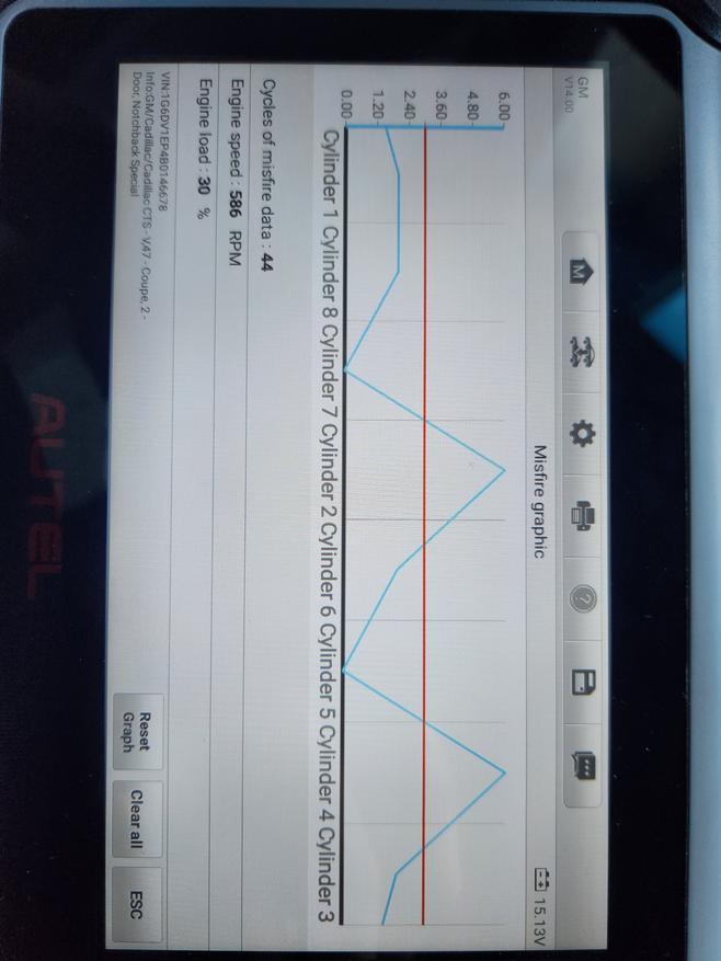

Still getting this service Stabilitrak light and message, here is the misfire log from just a quick run around the neighborhood
