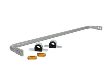

I put one of these on the car and I love it!  Really wakes up the handling.  I did a 19mm on the Elantra touring when I had it; this one is a 22 and it feels great.  I believe the OE bar is a 17mm.  For under $200 and about 45 min in the driveway--highly recommended
Whiteline Raer Sway Bar
Tony Sestito
Tony Sestito UltimaDork
8/29/24 2:27 p.m.
In reply to FSP_ZX2 :
Noted! That said, I think this car already handles really great. It's one of the better handling FWD cars I've driven.
