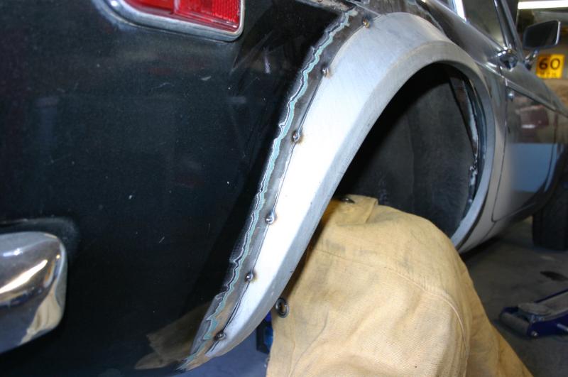

Almost done! I got all four fenders on, and I figured out how to "stretch" the rear fender wheel arches to make the tires fit under them. It's impossible to explain in English, you'll just have to see the next youtube video. Ok I'll try to explain: if I push inward and upwards on a bottom corner, it causes the sheet metal to bow outward maybe 5 to 10mm. And if that's not enough then maybe adding some negative camber will be enough. The front still remains to be seen but I can roll with the smaller diameter wheels if I need to at first.
Ok back to work...
Edit: finished "stretching" the rear fenders, and got the battery cable routed under the car and into the trunk area. Stretching the miata by 6" didn't seem to effect the battery cable. Must have been enough slack in it. Only think left to do now is the rear hatch door, the headlights, and to put the wheels on and cross my fingers that they clear the fenders. If they don't then I'll go down to the auto parts store and do the unthinkable

Unfortunately the tires where hitting the fenders in the rear, even after "bowing" them outward. I thought maybe I could put the old wheels on, which are 1" smaller in diameter, and at first I had the clearance needed. But I guess the coil springs where still settling after being at full droop for a few months while the car was on jack stands, because when I drove it to the gas station (about 0.25 miles away from my house) the clearance I thought I had was gone and the rubber on the tires was melting and making a mess.

Since it looks like you have to do flares anyways, here is a poetic path forward. These are metal flares harvested from a VW Rabbit repair panel.  I understand they are relatively inexpensive as a bonus.

I don't want to think about the fender clearance issue right now. Smaller tires would be a good way to throw money at the problem for the time being, maybe.

As for the fenders I'd use one of the eastwood fender rollers. You'll be surprised just how much you can stretch the fender arch out without to much effort.
