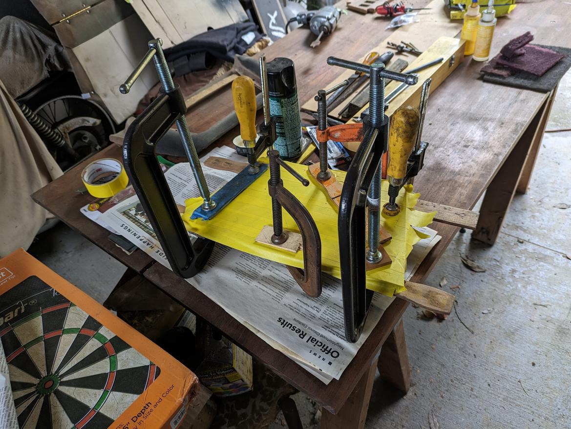

3/3/24 5:18 p.m.
New switch panel.
I cut up the original mahogany plywood for weight savings and epoxied it to the back of the new panel.
I want the panel to be a lightweight piece and yet feel and sound solid. Hope I don't have to glue a strip of sound deadening material to the back. The switches are probably going sound pretty percussive.

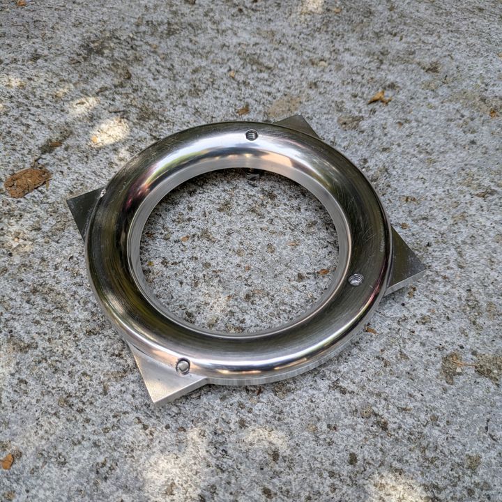

Today was about gathering parts in anticipation of visiting the car tomorrow.
This had been tossed into one too many bins, scraped up, and had too much masking tape stuck to it.
Bucket
Water
Scotch Brite ultra fine
1200
2000
3000
Metal polish
I'm normally not into polishing but this part deserves a little more pride. It's the starting point of the intake tract, right behind the air filters. I designed it based around research I read about different bellmouth shapes at a venturi intake vs none, and what shapes were most effective. It echoed what Gary from TWM Induction told me. Even if you have next to no space, you're still much better off with the smallest 180 degree bellmouth, than nothing at all. It's part of an overall attempt to not leave horsepower on the table.
