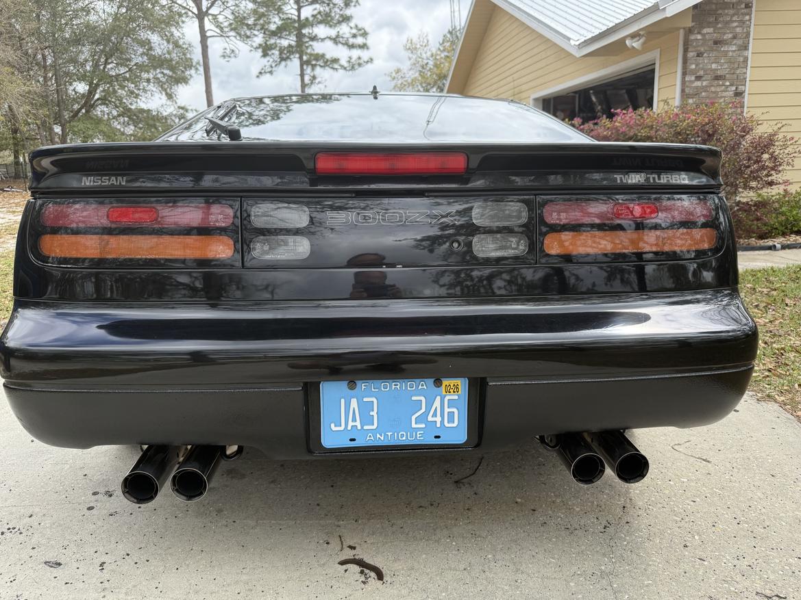

tb said:
Some previous owner of great taste and unchallenged virtue did the right thing with that oem hood ornament.
This inspired me to give the back of the car the same oem treatment.

In reply to a_florida_man :
I found those decals in my garage not long ago... guess I never got around to putting them on... getting the gold metallic pin stripe tape off was my biggest priority iirc
Great minds think alike? Better off in your hands, though!
Without the old wheels the gold pinstripe would have been odd. I'm happy you saved me from having to do that... lol
