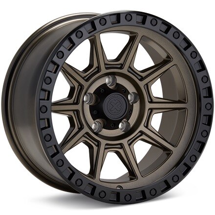

I took Snoball back to Discount Tire to have the same tire patched for a third time. First time found a nail, second time didn't tell me what they found but it still leaked. This time they told me they found the problem - the rim bead-seal surface is pitted. They put some sealant on it and said it's holding but no guarantees on how long.
I kind of want to put a set of these on it:
Image result for ax202 bronze
But since I don't have $1000 to throw at it I've put up an ad on FB looking for factory gold snowflakes in good shape. I can probably get a set for $100 or less.
Ah, the joys of vintage motoring...
