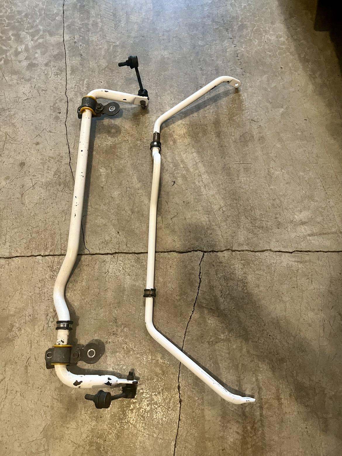

These are used aftermarket swaybars I bought a while ago off Yahoo Japan Auctions. They are purportedly from the Japanese tuner Take Off, and seem to be quite rare. I got them exactly as seen here. Not pictured are the oversize clamps for the rear, as they are a split aluminum block that isn't easily attached to the bar. I have no bushings for the rear body side mounts. I do have new end links for both front and rear.
The Take Off front measures just over 25mm, or just about an inch. The stock front bar is 20mm, or just over 3/4 inch.
The rear Take Off rear measures 18mm. I haven't measured the stock rear bar, but I'd guess about 16mm or 5/8ths of an inch.
The plan is to strip the hardware, test fit, and once confirmed, clean them up and paint or powdercoat them. (I've learned the hard way in the past about putting effort into cleaning up used parts before attempting install/test fit and being burned.) Then source bushings as needed, and install.
While I have it up on the lift do suspension, I might do a little exhaust work as well.
