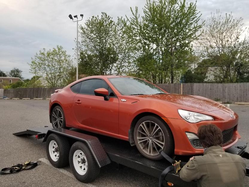

This also marks 5 years since we purchased this car in knocking, largely stock condition- 22 logbook entries, 12 rallycrosses, 5 sprints between these photos:
