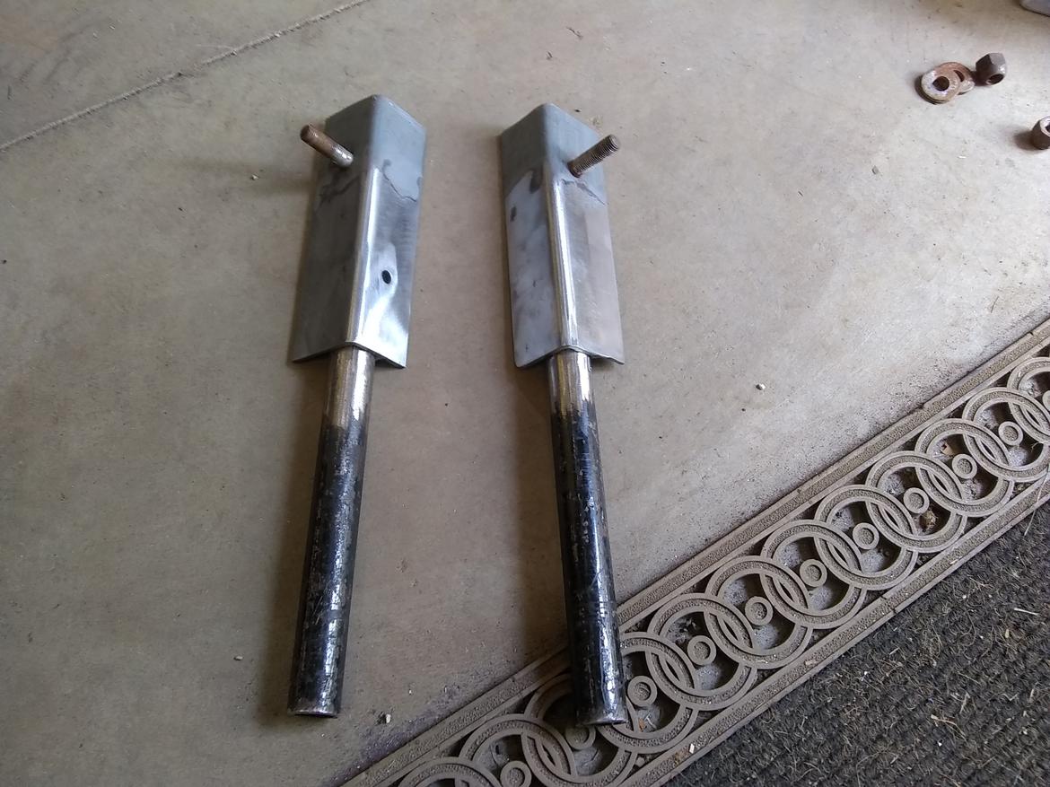

Here's the other half of the square tube I used to make the chain guard.
Ahhh. Nice. Between this and the welded doors, the body got a lot more solid.
Now, to start mounting the body to the frame. Carefully mark.
Cut and prep.
Weld.
Find some scrap, this black pipe had nearly perfect OD to fit in the other tube.
Prepare your hinge.
Drill holes and weld and weld in bolts.
Bolt in, using large washers and what I'm pretty sure are original lug nuts!
Hinge works great. Service position unlocked.
More was done today, in the next post, I'll detail the rest.
