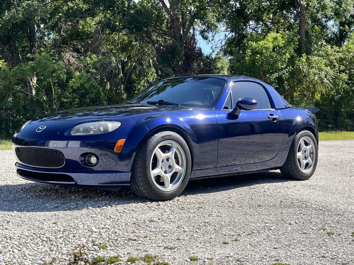

5/11/25 5:47 p.m.
Current ride height situation.  I'm expecting it to settle a little more with more miles. I put new shock boots in with the coilovers that have a fairly significant spring seat built into them.  With time and miles, the springs should squish those down a bit.
