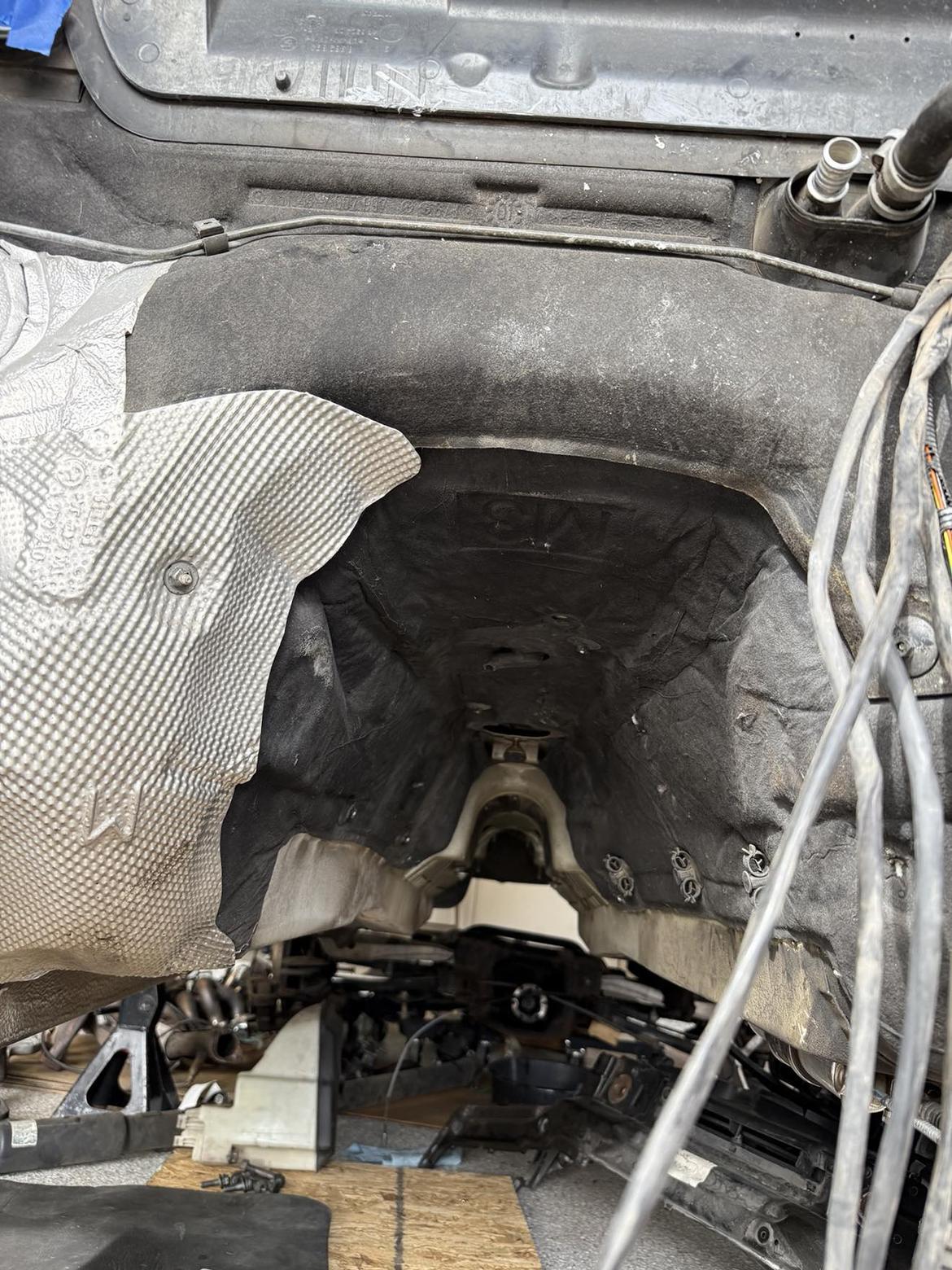

Next I had to do some additional prep work on the wagon, the fuel system is pretty different but all plug and play, M3 pump and tank baffle went into the tank, fuel lines/filter got swapped over:
I couldn't see any differences in the M3 transmission tunnel insulation, but it's stamped M3, so with some extra help that got moved over. The heat shields are likewise all stamped M3 so those came too, they actually did have some discernible shape differences presumably to clear the headers.
After a bunch of time staring at a pair of empty engine bays and doing research online I decided I'd bite time bullet and swap the ABS systems too.

Wrapping this up Sunday didn't happen. By the time I finished prepping the car, I discovered I couldn't find my 200mL dispenser. After quite a bit of looking I determined I might not have brought it with me when we moved. A replacement showed up yesterday, so I snuck out of work a bit early figuring I should be able to glue everything in place during the 60 minute working life of the material.
L
O
L
Some of the bits that took me longer than expected, cleaning/prepping/priming all the surfaces that won't get epoxy with etching primer.
I coated the back sides of the parts too where epoxy wasn't going to touch, you also have to rough up the epoxy surfaces to get a good bite:
I mentioned expecting to spend an hour gluing everything in place, It wound up taking me closer to 4.5 hours. I was originally panicing after I spent 40 minutes applying epoxy and putting rivets in the main rear bar before I realized that the material doesn't mix until it's in the dispenser nozzle, so as long as you keep using the material within 60 minutes you can keep working with the tube.
The 3M structural epoxy goes on silver, but dries purple. The only spot I really deviated from the instructions is replacing 4 of the rivets on these front gusset cups with rivnuts. The wagons have 2 little tabs here that a trim panel clips into. so I'll have to fab up something to replace those.
I used a pair of flywheel bolts plus the huge subframe washers to clamp the rear bar in place while I riveted everything in place.
The bottom side reinforcement plates cover a pretty huge area which I like. But working with expoxy that's threatening to drip on your face the whole time was a bit difficult.
And that's it! one of the last large milestone projects completed before I can make the car a rolling chassis again! Next up is rear subframe bushings/camber arms. and then I should be able to roll the car around.
