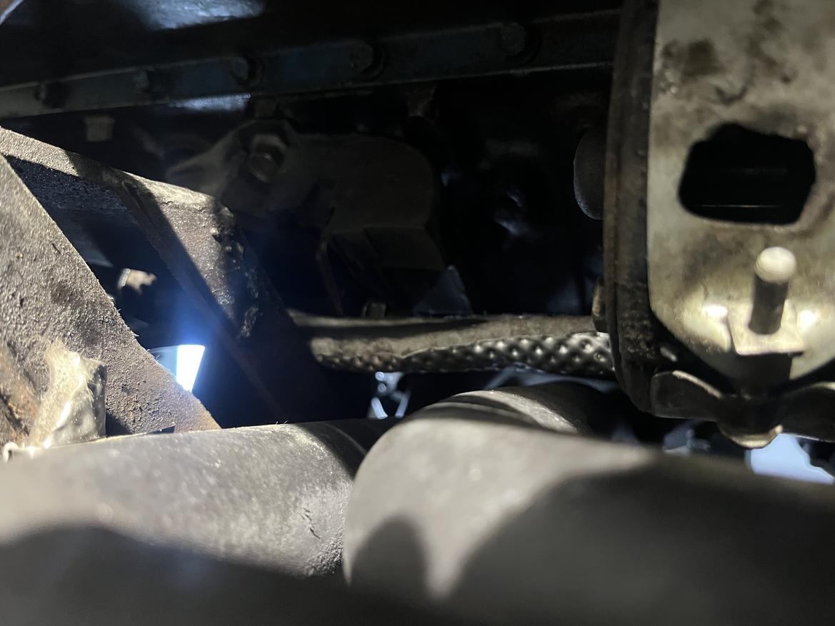

There wasn't much time for garage stuff yesterday but I did knock out a few jobs. The exhaust is now fully tightened down although I won't be surprised if the collectors need to be cinched down a bit more.
Next on the list was the little boot that goes over the clutch linkage. It's been missing since I bought the truck and I've since just covered it with aluminum tape. This is better.
The driver's front brake line I mentioned before is way, way too close to the header. Heat shield and stainless ties to the rescue again.
And here's a look at that starter wire from underneath.
