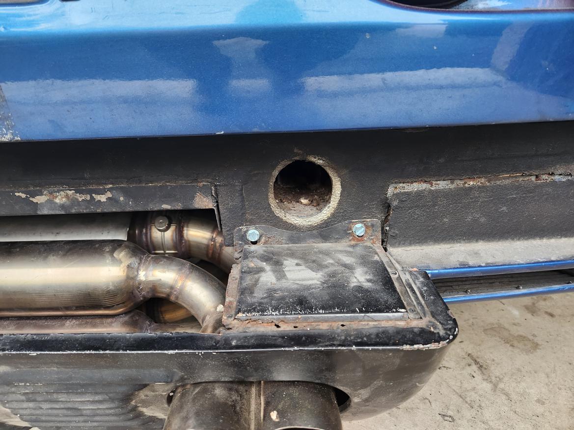

I feel like such an idiot.  I spent almost 2 hours looking through boxes for the muffler cover bolts  last night and this morning I realized I'd left them at lowes
Also last night I glued the bumper up last night, it was a little delaminated from the fire.  Bumper is stretch maybe....this is a "euro" bumper reproduction that is just a light weight fiberglass copy of a bumper and saves about 30-40 lbs.  I think I may have left the bolts for this at lowes :)

After the exhaust cover was on I thought I was ready for the bumper but it looks like the grommets are gone so those are ordered.
and I think the bumper bumper shocks are broken....I'm pretty sure they are supposed to be aluminum
I decided the stuff I have is also too heavy so I ordered some 1/16" wall and since I could only fine 1 of the 14mm bolts I bought new 8mm bolts which seem more appropriate to secure a decoration.  Its kind of nice to be checking non-engine stuff off the list.

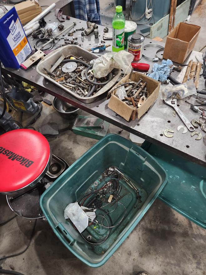

I started pulling the engine and if I'm being honest describing the effort as 1/2 hearted would be an exaggeration.  But I drained the coolant, decided to flush it so on reassembly its antifreeze free and ready for head gasket sealer...then I realized I need to get the water out of the block and fought 1 of the drain plugs out.  It will be out Friday or Saturday I guess and hopefully head off Sunday.
About that time amazon brought me the MAP sensor I wanted to see...its small and nice.  In theory I could probably put 1 on each port but they would block my access to the manifold bolts.  I'll look at that a bit more when the engine is on the bench but right now I'm thinking use a short hose and hide them under the air box when all the hoses are now.
The aluminum tube i ordered for the bumper mount came...but I didn't order what I thought I ordered exactly.  This is 3mm wall, I thought it was 1.5mm.  Also the grommets I bought give a smaller ID than I was thinking o a different tubing might be better.  I would have liked to wrap this up so before pulling e3verything apart but I don't want to wait for more bits so I'll pack it up for now.

Today there was still water on the floor from draining the block yesterday....I squeegeed it and moved on the picking up because I have bits of all sorts of things everywhere let form the get it done push plus it was honestly a mess before and that has to do with me being easily distracted from work I don't enjoy...oh look at all these spark plugs is various stages of fouled.
The NGK set I've been using was looking pretty worn out so they went in the trash but I have another NGK set (or 11 = 1 smashed from the last failure) that look pretty new so I ordered a 12th and cleaned the 11.  I also have 2 full sets of autolites, fouled.  In the V8 blower engine I really like autolites which is probably why I bought these for the V12.  They look hotter than the NGKs and I'm not sure how I feel about that which is likely why they are sitting, I honestly don't recall.
I did drain the oil before coming in.  Then Standing there waiting I took a closer look at the muffler....man I did a poor job building that, its off a full inch right to left so one more thing on the list.
