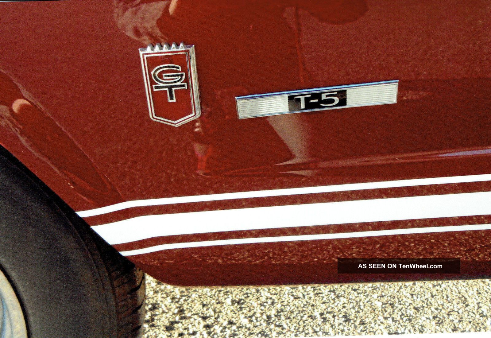

Mustang vs. T-5:
T-5:

The Mustang was exported throughout Europe. It was only known as the T5 in Germany. Everywhere else it retained the Mustang name. DSO codes started at 91 I believe, and went progressively up as the production run went on. My car has a DSO of 95 a do its sister cars. On the exports brace, if you look at the cowl bolt spacing on a T5 they are evenly spaced. ( also the same on a REAL Shelby.) Aftermarket export braces have a 2 and 2 pattern that matches the factory cowl brace bolting on a US car.
US Spec car
T5/Factory Shelby
Production Numbers for the 65/66 T5 are non existent. Ford had storage issues and dumped all of its data for those years. The production number is guessed to be less than 1000 cars/year 65/66. My car looks to have been a German Civilian car of which there were 624 registered in 1966. It is one of 98 still known to exist (world wide) today. By comparison, there were 2380 Shelby Mustangs built in 1966.
